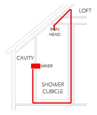

I'm thinking (and this is where I need advice) that it's to do with my plumbing between the mixer and the rain-head.
My theory, that I'll test tomorrow is that if I disconnect outlet from the mixer it won't dribble. If that is the case then somehow water is getting pulled through the system due to the unusual shape that the pipe takes.
Here's my theory, can anyone advise if it's nonsense!:
Here's a diagram of the pipe to the rain-head (in red):
The sloping roof-space seemed impossible to run a pipe through, plus the ceiling above, so in the end I shaped a 15mm pipe with a couple of kinks and pushed it up into the loft space where it meets a vertical pipe, that runs under the shower tray and joins.
My crazy theory is that the last few feet before the rainhead, at 45 degrees, has water falling out of it when the shower is off, and somehow, even with the mixer turned off, the syphoning effect is enough to pull more water through.
Is this possible?
Or is there a much simpler theory? Why is it dribbling so much? How can I stop it! (Even with the head off it dribbles of of the pipe)
It can't be syphoning, because the outlet is higher than the inlet - it would be a perpetual motion machine! :LOL:

The water continues forever, so it's not just in the pipe. I dis-proved my silly theory anyway today- I disconnected the outlet from the mixer and it continues to drip from the mixer, so it's definitely just the furring up of the internals from our hard water.
