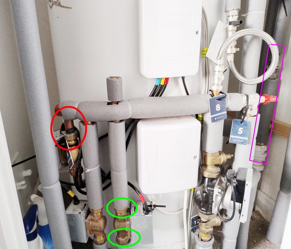

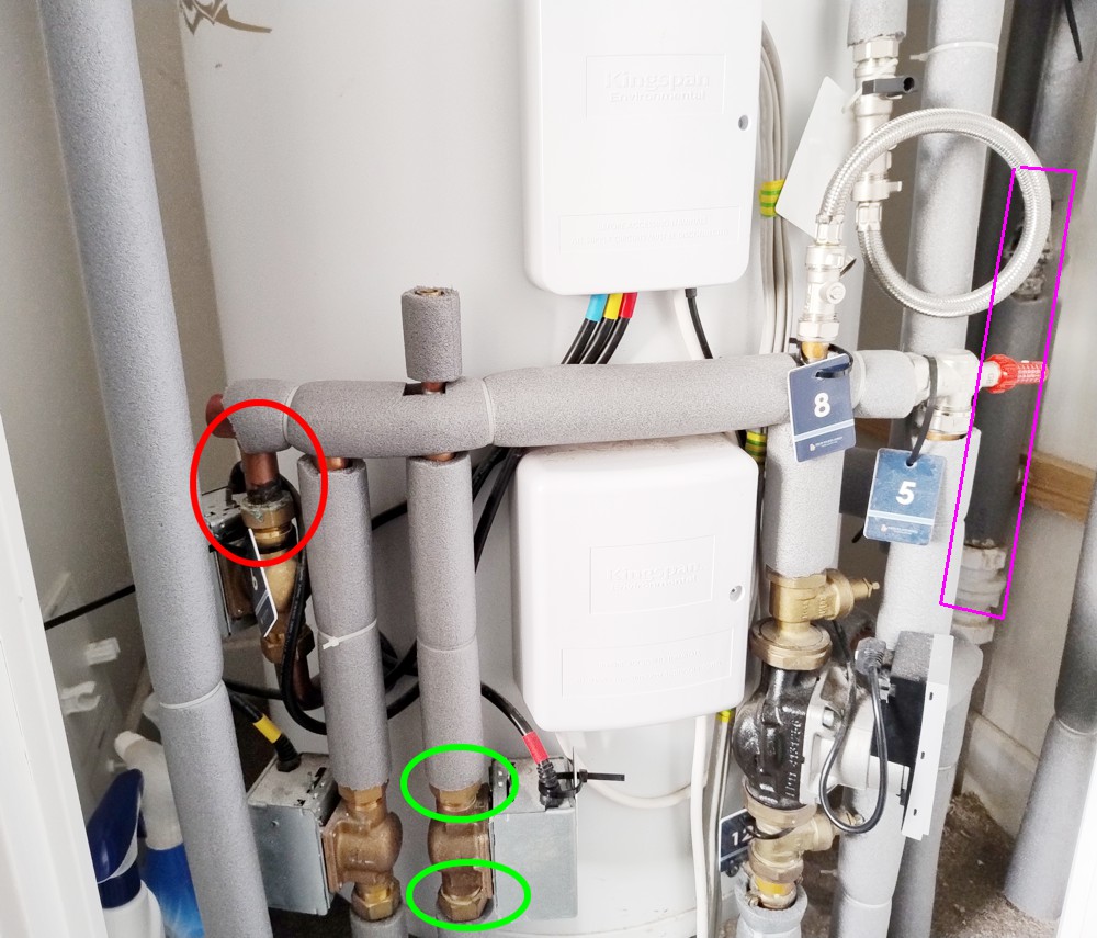

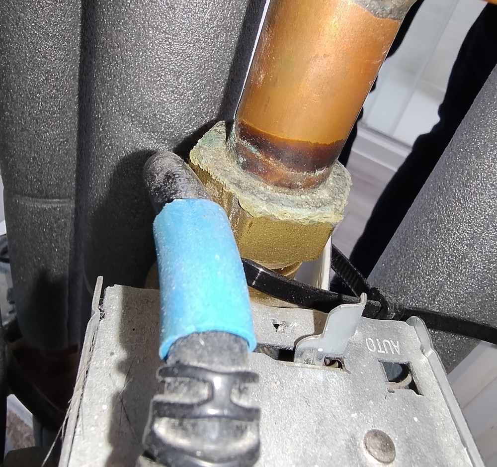

Thanks for your replies. I've attached two photos. One shows a close up of the leak. The other shows:
1. Highlighted in red - the current leak. You can see the connection looks dirty and stained, like it has leaked before.
2. Highlighted in green - the two connections that were leaking but have since been repaired (and seem okay). Before I had them repaired, these connections were clean and didn't look like they had been leaking previously.
3. Highlighted in purple, you might just be able to see that the tundish has a lot of historic scale around it. This made me think the previous owners had been battling some ongoing problem. However I recently learnt that the air gap in the cylinder needs replenishing periodically, which the old owners might not have known about or might have been slow to do.
My thought is that when the air gap needs replenishing the hot water pressure increases (you can feel this through the downstairs kitchen tap) and some of the joints in the airing cupboard were shoddily done, and start leaking under the extra pressure. Does this sound like a possibly theory?

That's a motorised valve that's leaking has above nothing whatsoever to do with cylinder.
Whilst compression joints should hold just by being tightened I always use a smear of jointing compound,
Bit belt braces and length of string but much better than been called back.
Agree, the two joints that have already been repaired used a smear of jointing compound and they've been water tight. Just a shame I seem to be working through every joint in the airing cupboard.
I prefer not to use joining compound
If a joint leaks, it is because the olive might not be a quality one or fitting issue. In that case PTFE on the olive will sort the problem
These are manipulative fittings ie at some point will need dismantling. Jointing paste when it goes hard will cause more problems when fitting is remade.
Above is just my thought, not saying do not using jointing paste. If that is what ricks your boat, go for it.

Why not tighten all the brass capnuts so the issue is fixed
Next time something leak the bite the bullet and have the system drained. Strip all nuts, clean, paste, tighten. While you at it add an inhibitor to protect and service the cylinder and the boiler.
It's more than likely poor instalation.
Thanks, plumber is coming next week to fix the most recent leak. I think you're right, I probably need to bite the bullet and have all the connections redone. I suspect he won't have time to do it this time around but will suggest it as the next course of action.
That looks to be Range Tribune pre-plumbed cylinder with factory made joints. Expansion gap probably needs recharging if those joints keep leaking.
Yes it is.
The gap was replenished after the tundish dripped and then I noticed this leak a couple of weeks later. Same thing previously when the tundish dripped and the plumber replaced a pressure relief valve, then two weeks later a leaking joint was spotted. That's why I mentioned above, are the leaks happening due to a combination of poor install and an increase in pressure whenever the expansion gap needs replenishing? I also notice when the gap needs replenishing and you turn on the water heating, there is an initial "blast" of pressure from the kitchen hot tap when you first turn it on.
