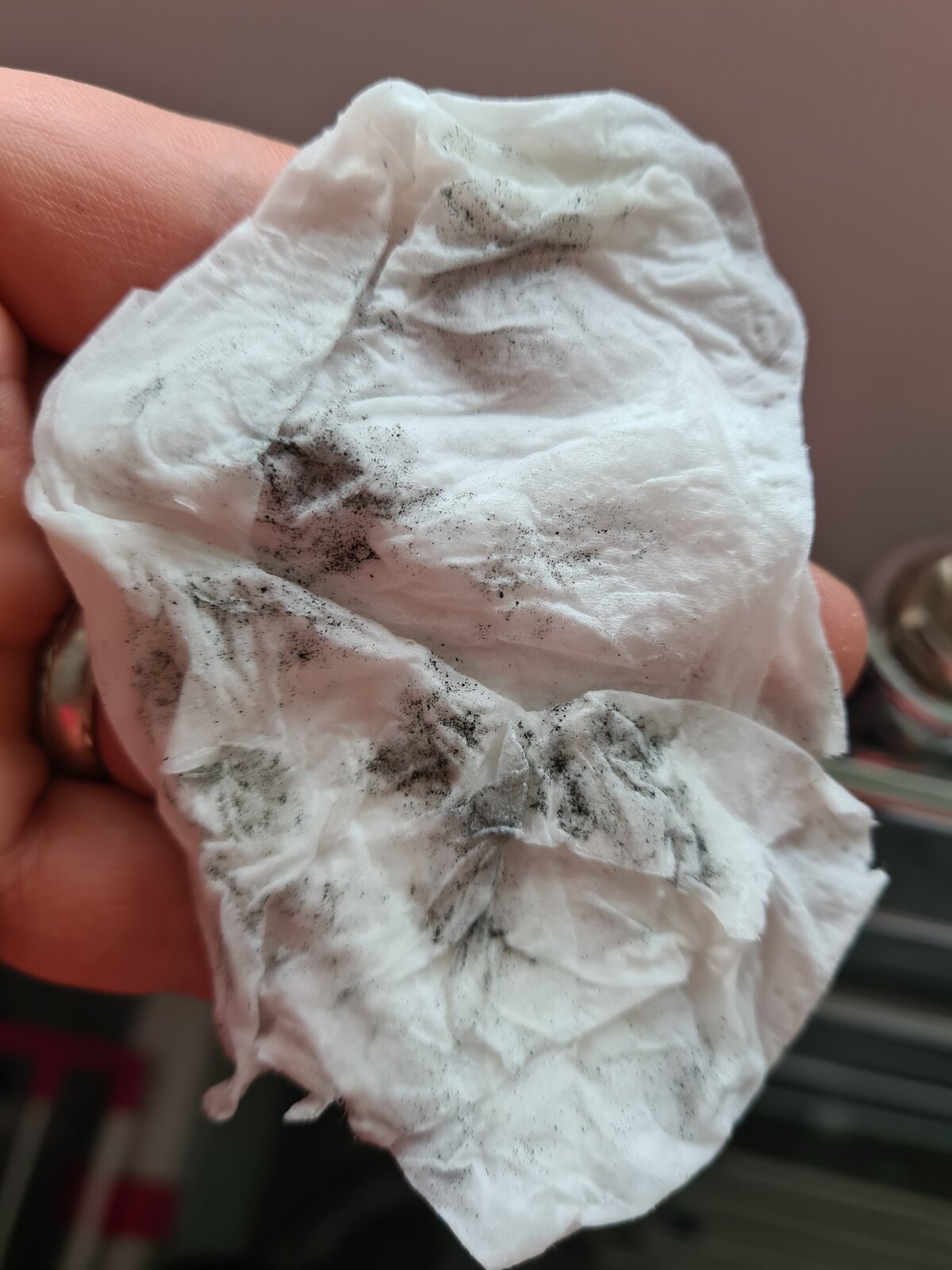

Now with 5 new rads added... I have to bleed every few days, loads of gas comes out (upper floor rads). It's been weeks since CH went on, surely there's no way that should still be air trapped during the system refill when the work was done? I tried trapping the gas in a cup and lighting it as I read online - does not pop, so does that mean air is getting in somewhere rather than hydrogen from corrosion? But I see no leaks anywhere!
Second thing - when water splutters during bleeds it's really dirty with black particles (see pic). As it seemed clean before the renovations, and old rads which may have had sludge at bottom were removed, is it normal for an essentially new system to be so dirty?

make sure the system is switched off when you bleed the radiators, you dont want the pump running as you bleed them, your pic does show some contamination, but perfectly normal to be honest, so much is made these days that system water should be like unicorn tears
The best trick I find is to bleed the radiator into a glass and see how clear the system water actually looks once it settles, do you have a mag filter installed? If you are having to continually bleed then it's either making gas (which you've tested for) or it's losing water, can't be anything else.

The disturbance of the pipework and rads during the boiler change will have released some silt back into the system. Your new boiler pump may well pump better than the removed one, and thus more silt will be lifted into circulation. Your mag filter should catch this, though it's worthwhile cleaning the filter thoroughly and then checking it a week later - this will give you an idea of the amount of cr*p in circulation. As said, dont get too hung-up on its colour as long as all parts of all rads are getting hot.
