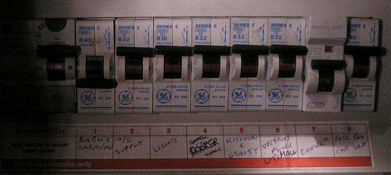

When you say there's no individual RCD that trips, do you really mean individual RCD or do you an MCB or RCBO? There's a very big difference between them. RCDs will usually protect several circuits whereas an MCB or RCBO protects only an individual circuit, often, in the case of MCBs, with additional RCD protection above them. Sorry if this is teaching you to suck eggs but clarification is important. Do you have a picture you could post of the consumer unit and identify exactly which devices are tripping?

Hi
As requested, i've uploaded an image of the fusebox. It is the far left main switch that trips (not the mcb currently off). During the trip there are no timed appliances running.
mmm one RCD covering everything. Not ideal especially as it looks like you have significant outside wiring (a barn and a caravan?).
As others have said if it's a neutral to earth fault switching off the MCB won't help.

This consumer unit provides supplies to :-
(1) A recently built barn which then has it own fusebox. Sockets/Lights. Nothing switched on here during trip. This is the supply with replaced underground connections.
(2) A recently built shed containing a fridge/freezer. This would have been on during the trip.
(3) An outside light with PIR.
The caravan has been scrapped.
Since switching off the 1st MCB (1) a few days ago the main switch hasn't tripped.

As you have isolated the barn circuit and the problem seems to have gone away it could be that there is a problem with the wiring out to the barn. When the underground connections were replaced was the rest of the cable in a good condition? Did the electricians who repaired it provide any figures such as insulation resistance for this cable? It sounds like there may be a neutral/earth fault.
Another posibility is that with this circuit switched on there is enough earth leakge combined between the whole installation to trip the RCD but with it off it falls just enough below 30mA to trip.
