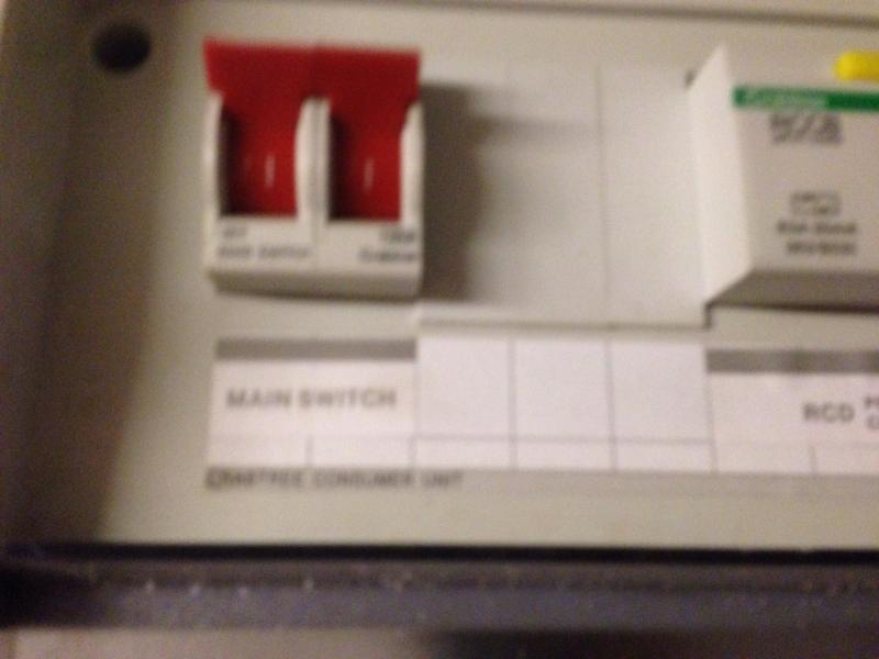

Is the whole system protected by this device, also acting as an isolator to the whole system?
When open the main isolator to the off position does this also cause the RCD to go into trip mode?
Is there more than one RCD, if so do they also trip?
If not are they of the same type.
Photo and details printed on the device would be extremely helpful.
Some RCDs are passive and some are active, one will trip on power loss at the supply, the other does not.

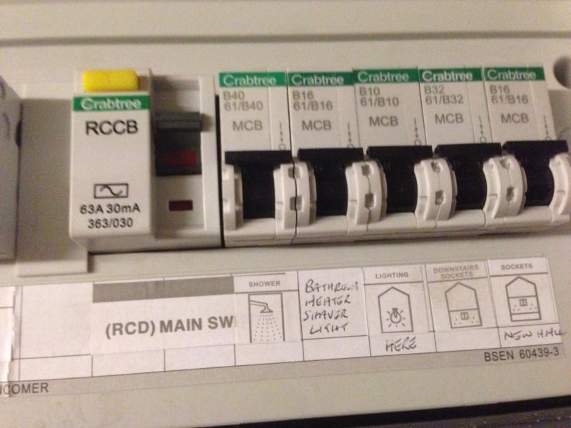

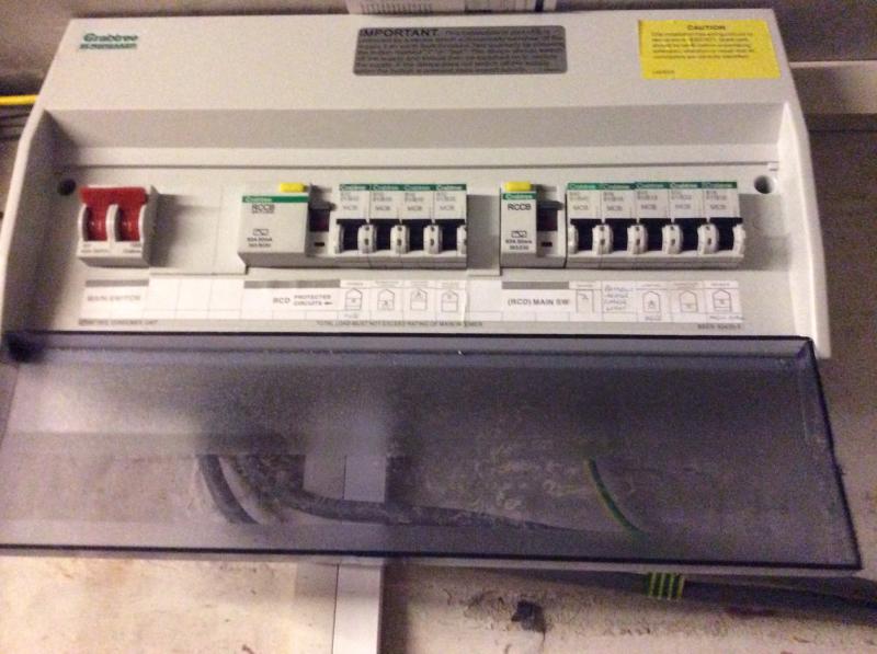

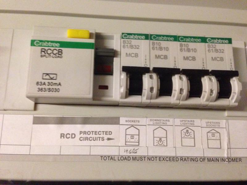

I am interested in the reply to this too. This same thing happened to us last night. We rarely get power cuts all mains cables locally are underground..
I woke at 4am no power in street, no porch lights on nothing. After an hour I grabbed a rechargeable torch and set off downstairs. By happy coincidence once I had entered the garage (where the consumer unit is located) I noticed the neighbours drive floodlight come on. But our lights didn't.
The consumer unit is a Crabtree model with two RCCBs protecting two circuits plus a double main breaker. The first RCCB has split load and 4 MCBs, the second is none split load and 5 MCBs. Anyway I checked the direction of each breaker including the main one and all were on. I flicked the double main breaker from on to off and back to on again and voila the power came on.
Why is this. What happens if we get a power cut when we are on holiday. All the food in the freezers will perish...
Is this normal for modern RCCBs?

Can you upload a pic of RCCB/RCD or part no.
