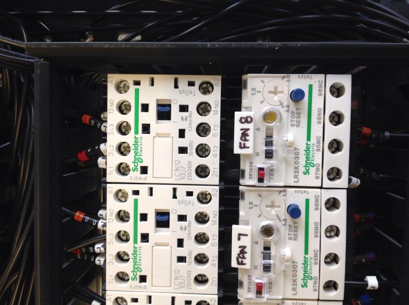

I think I am having a blonde moment..
Can't work out how the hold on contacts on this Schneider contactor and overload combination should work.
When connected together the coil a2 is connectoed to 96 on the NC overload contact, which is fine.
But then the NO contact 14 where I want a live supply to come through and back to A1 to hold the contactor on, is also connected to 95 on the overload.
This causes a dead short through the overload live to neutral.
(240v coil). Can't get my head around how this should work?! Any ideas? :oops:
The contactor has only three contacts for the load the forth is not rated for load it's only for use as a hold on contact. You can get add on contacts to use for aux and I have used the forth for neutral, but listed as 3 N/O Contacts, plus Auxiliary Contact 1 N/O.
Sorted.. I knew it was a blonde 5 mins! :oops:
Always ever used A1 for live and A2 for neutral, this one needs A1 to be neutral! :LOL:
