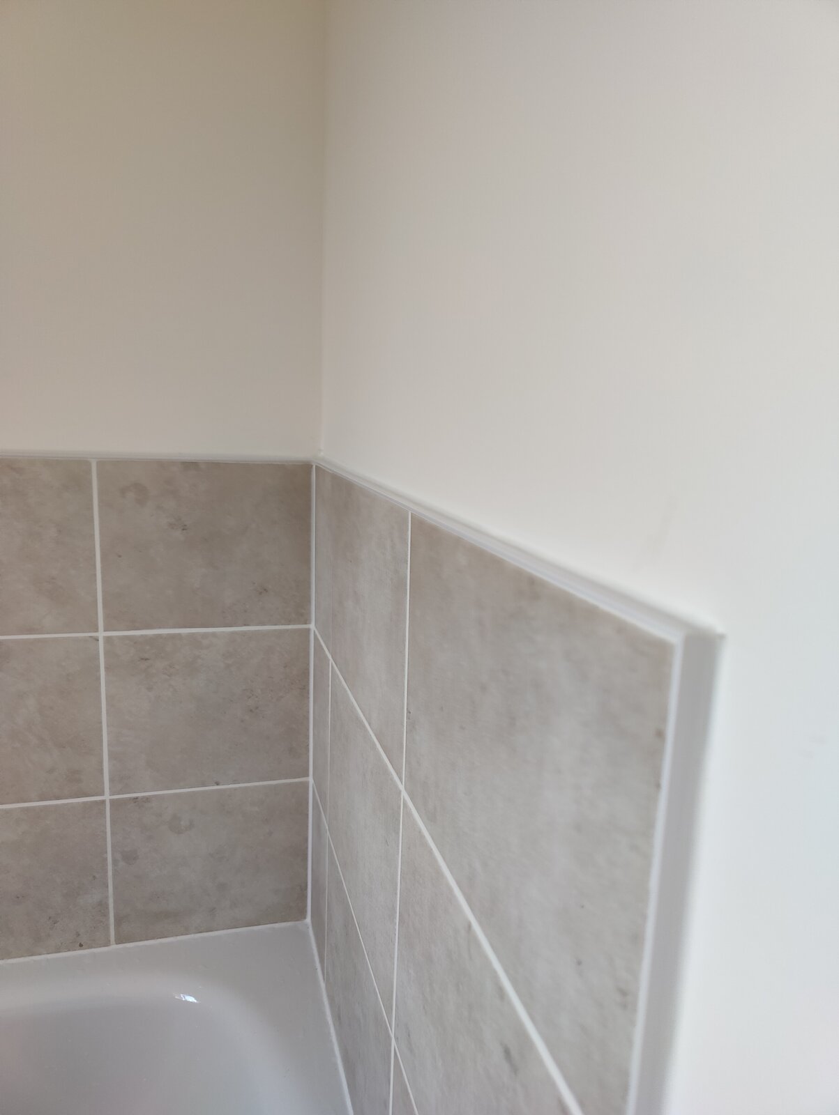

Hiya,
I'm looking to continue the tiling on our bathroom which is half done, I want to continue it from the trim to the ceiling.
Question is, how do I work with the trim, how do I remove it to continue the tiling?

I'd be surprised if you can remove it without damaging those tiles. You could offer some tiles up above it and see what you think.
I've tiled above trim before for a customer who changed their minds and tbh it didn't look that bad with the trim. It almost became a small feature but as it was in a grout line it wasn't that noticeable

Interesting that! As it's a new build they only do half tile, I might see what it looks like with the trim in place.
Sharp wood chisel and mallet, if it’s on plasterboard might be difficult .
I have the matching tiles. The trim is plastic and is adhered to plasterboard
