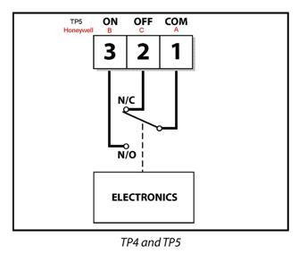

Hi everyone
Having had a new combi fitted, we are changing our controller from a Danfoss TP5 to a Honeywell CM907.
My question is how the connections correspond. The wiring diagram shows basically the same system, but I wanted to be sure before going for it.
The Honeywell has three terminals marked A, B and C
The Danfoss has: 1 (COM) 2 (N/C) and 3 (N/O)
Any help is gratefully received

Yes, the boiler is fed directly from the mains to the L, N, and E terminals of ST10. The boiler is turned on/off by having a switch (e.g. programmer or thermostat) which links the Ls and Lr terminals. This has to be a volt-free switch.
You said:
Looking at the switching diagrams for both controllers it seems to be that
Danfoss Honeywell Boiler connection
1 COM A Ns
2 N/C C Ls (constant live?)
3 N/O B Lr (switched live?)
NO that is incorrect. You need to get a better informed BG engineer!
This diagram shows what the terminals do. As you can see, A/COM is the feed to the switch, which can either connect to B/ON or C/OFF. You therefore need to connect the Ls terminal to A/COM and the Lr terminal to B/ON. The B/OFF terminals are not used.

Would you be able to confirm the connections in terms of the Honeywell A, B and C terminals based on how the Danfoss was wired.
I completely understand everything you've said, but can't get under the floor to check the continuity of the cables used to connect the boiler to the controller. There was an extension to the original cables when the boiler was moved and the floor is now tiled above the junction box that was used to extend the run. The cores at the boiler bear no relation to the colour of cores used at the controller and as a result I don't know which is connected to Ls and which is Lr.
Basicallly, if you could tell me where Ls and Lr are connected at a Danfoss TP5 then I can take it from there.
Thanks again
Ls should be connected to the COM terminal and Lr to the ON terminal. So the wire connected to Danfoss COM should be connected to Honeywell A; and the wire connected to Danfoss ON should be connected to Honeywell B.
If you want to be doubly sure, use a meter/mains tester to check which wire is live when the thermostat is turned down. This wire should go to A and the other to B.

Live Supply (LS) to A, this is your common.
Live Return (LR) to B, this is your switch live or normally open.
Sludd think of a room stat like this. Common is always powered and then channels this power between the Normally Closed terminal (when stat is turned down) and the Normally Open terminal (when the stat is turned up). If you compare the Honeywell wiring diagram to the Danfoss one D_Hailsham posted you will see what I posted was correct.
Its ok D_Hailsham i'm not expecting any flowers or anything.
Thanks BGE - I'd already checked back to your original reply and realised you were on the money. My confusion lay in my not knowing how the existing Danfoss connections related to the Ls and Lr at the boiler, due to the cable run being extended. Your first post meant this didn't matter - it was trying to work out the relationship of danfoss controller to boiler terminal that got me confused
