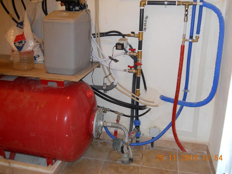

Here is a photo I took of an installation in a large villa I maintain.
This has a mechanical pressure switch as you can see.
A boiler is also wall mounted above the EV just out of the photo.
The sub well pump is 200m down a bore hole.
Runs 6 bed villa 4 bathrooms.
controller 9 euro.
