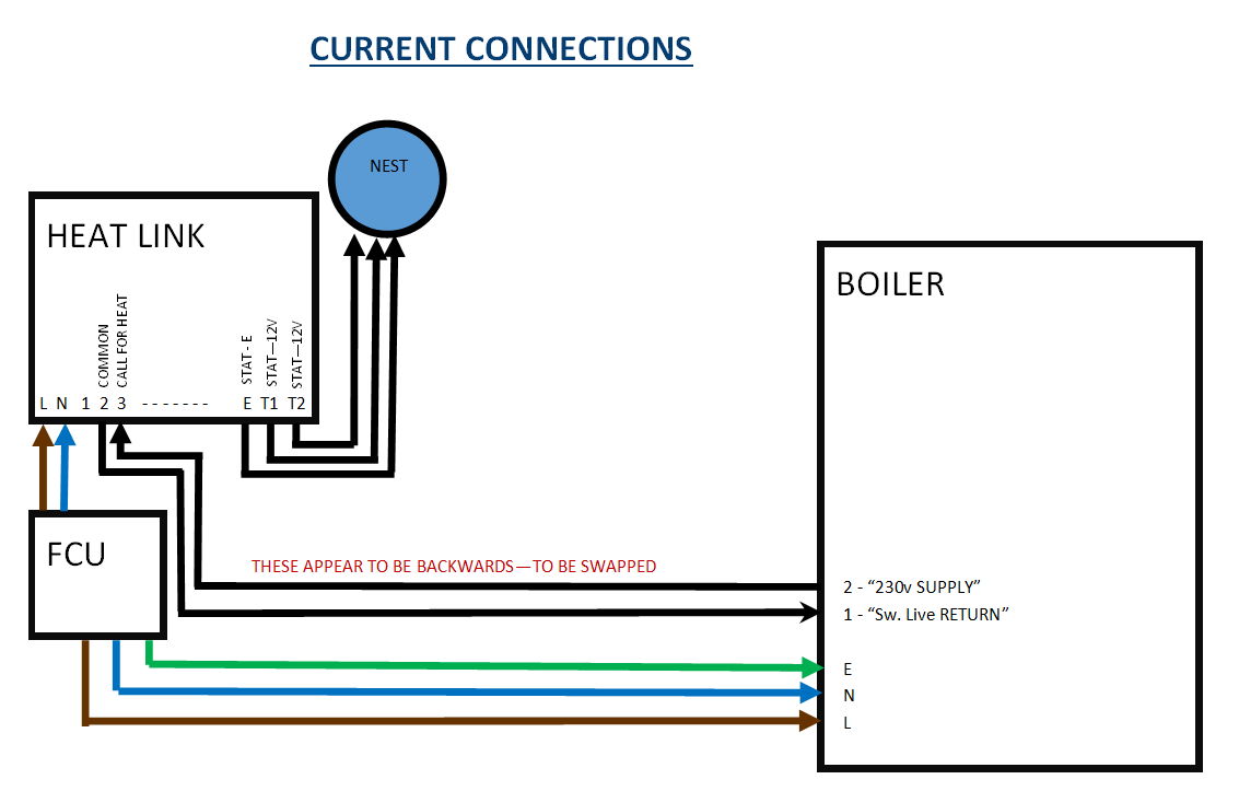

Hi all,
I have an existing Baxi EcoBlue Advance combi boiler controlled by a Nest 3rd gen via Heat Link.
I’ve just installed an Omnie UFH system (wet, boiler fired) and am trying to connect up its wiring centre, with it being controlled by the same Nest (as opposed to Omnie’s own thermostat). So one thermostat for the whole house including the UFH.
At the moment it works from a plumbing perspective without the wiring centre, but I have to turn the UFH pump on/off manually, rather than it kicking in when the Nest calls for heat and fires up the boiler.
So the bonus question first:
While reading up on this I was looking at the connections from Heat Link to the boiler (starting at the beginning!) and they seem the wrong way around from the docs I’ve read?
So I have:
Heat Link connector 2 > Boiler connector 1
Heat Link connector 3 > Boiler connector 2
The Nest manual states:
Connector 2: Heating relay common
Connector 3: Heating relay normally open/call for heat
And the boiler manual, for its connectors:
“The 230V supply at connection 2 must be connected to the thermostat. The switched output from the thermostat must be connected to connection 1”
Am I reading this wrong? Shouldn’t the boiler connection 2 be going to the Heat Link’s Common, and the call for heat going back to the boiler’s connection 1?
If so, how is the boiler working normally now?!
I was quite close (I think!) to understanding how the Omnie would wire in until I saw this but maybe I’m misunderstanding how the switched lives work?
thanks!

It is volt free connections so as long as heat link 2 and 3 are connected to boiler b1 and bk2 it does not matter which goes to which.
So to confirm, I could swap the two wires over between Heat Link and boiler to get them matching what seems to be "standard" installation, without risk of frying anything?
One thing - when you say they're 'volt free' connections, why does the boiler manual call its connection 2 a "230V supply"?

so all 230 volt should come from a single supply normally a FCU, I know with Nest it is volt free so really does not matter, but standard practice has always been one FCU to supply all central heating.
So this is what we have now, in effect - one FCU supplying Nest Heat Link's N,L,E directly with one cable, and a separate cable supplying boiler's N,L,E.
There's then a third 2 core (&earth but earth unused) flex between the boiler and Heat Link, as discussed, doing the call for heat switching).
I think supplying the boiler and Heat Link off one FCU maybe isn't regs, but this will be getting fixed when we renovate the room the boiler is in.
The UFH's wiring diagram seems to suggest running L,N,E from the FCU to its own wiring centre, then everything else can draw power from there.
But that's phase two of this thread, once I've confirmed what I've already got...!
Thank you again
Volt free means the contacts are not connected to the same supply that works the thermostat, so contacts could be 12 volt 24 volt 230 volt DC or AC the heat link is volt free so does not matter. With Hive duel wall thermostat the supplies are linked, so next thought is not so much what is there now as what may be fitted latter.

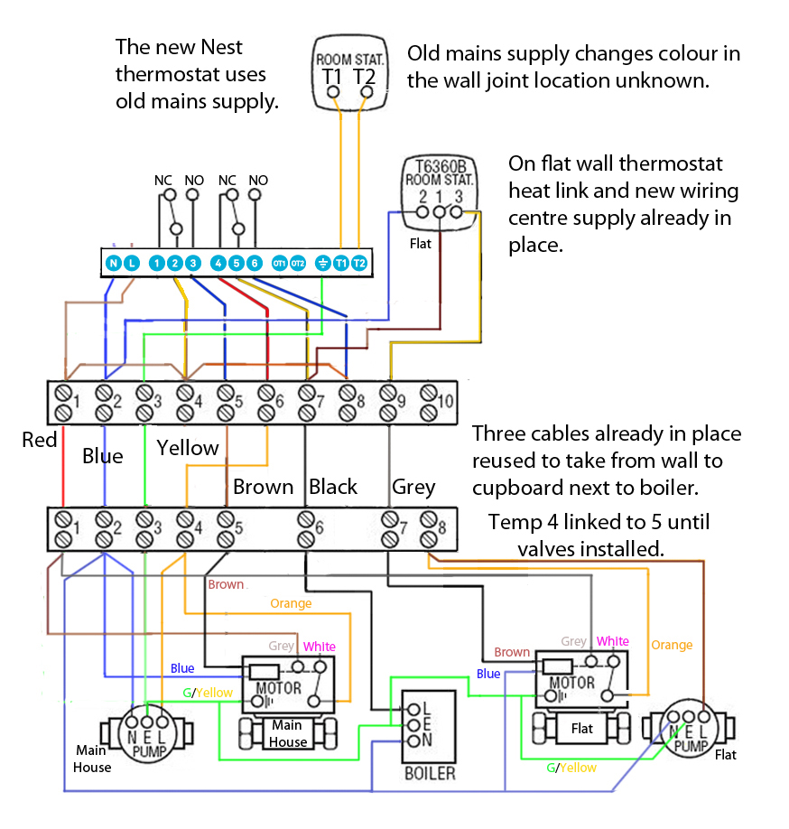

So ended up with this C_Plan_My_HouseD.jpg before I started to wire it up, my thoughts are I am 69 now, in 10 years time could I remember how I wired it? So planned out I have a chance I can pass this on to some one else. I would say you need to do the same, and once drawn out you can post it on here so any errors can be found, I have needed to add relays to that diagram as not plumbed as I expected.
But you have in your mind what you want the UFH to do, personally I would go other direction, and go for fan assisted radiators to speed up heating, not UFH which is slow, but that is a personal preference, nothing wrong with UFH in a home heated 24/7 and it is what I would select for example in a care home.

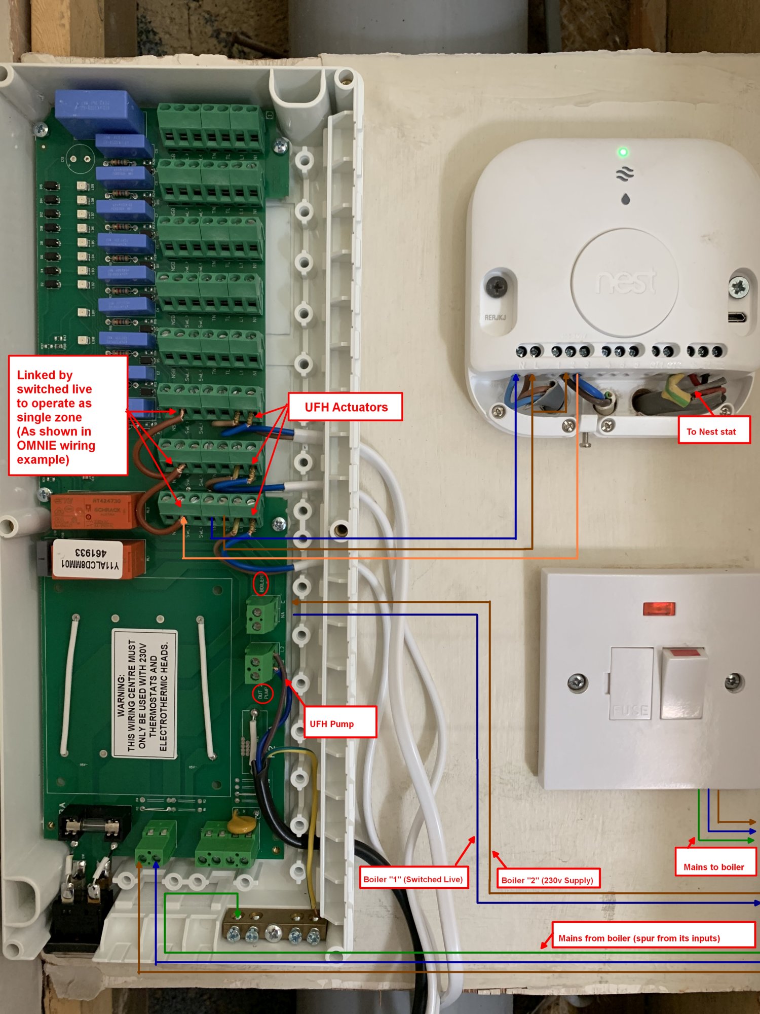

what model of omnie control centre do you have ?
Hi, it's the DS-EWC1 wiring centre
thanks
EDIT
Just opened it up again and realised that it does have what's labelled as "Volt Free Relay- Boiler" as well as the mains live output that goes to the pump.
The wiring diagram I got with the Omnie is not particularly specific (it shows the boiler connected to the mains live output along with the pump, via a 2 port valve. Obviously we're not using this as it's a combi)
So theoretically to loop the UFH into the controls, I could disconnect the Heat Link from the boiler and connect it to the Omnie Zone instead, then connect the boiler to the "Volt Free Relay", and the Heat Link should activate the UFH and boiler together when it calls for heat?
Yes that would work although I would separate the ufh from the rads with a couple of 2 port valves and use two separate stats (two nests or whatever stat you like)
Yes that would work.

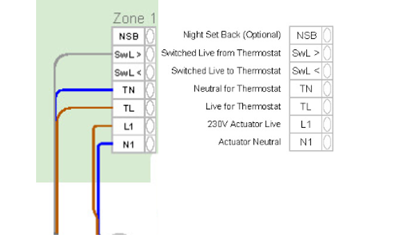

Excellent, thank you. So this just leaves one question regarding the Heat Link's connection to the Omnie Wiring centre:
All of Omnie's wiring diagrams presume you're using their own controls (of course), and have this kind of wiring at the zone terminals:
L1 and N1 go to their zone actuators, so that's fine.
Am I right in thinking that TN and TL would go to the Heat Link's mains power input, instead of the FCU powering it currently?
If so, their diagram has only one Switched Live coming back from the thermostat, so in this case, what goes to the Heat Link's common connector? Should I use the 'Switched Live To Thermostat' connector on the Omnie wiring centre? Or, I've also seen suggestions that you could bridge the Heat Link's Live internally into its Common?
Either of these will work, probably linking the live and common in the heatlink would be easier.
Great, I think I'm understanding this now, but am still working on drawing out a diagram beforehand, and will post that asap.
What's the recommended way of powering all this, if adhering to EricMark's advice of having 1 FCU switch for the lot? The boiler's manual advises to power it directly, and I've seen recommendations to spur back off the boiler's mains connectors to power a stat. With that in mind would this be best?
FCU > Boiler L/N/E
Then from Boiler L/N/E spur to the Omnie Wiring Centre's power input?
Then the Heat Link gets is power from there?
it really does not matter as long as the whole system can be isolated from a single FCU.
