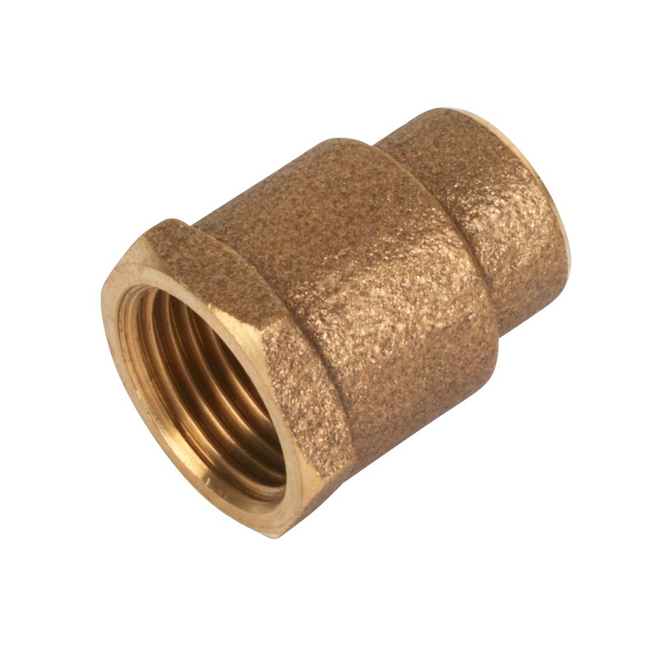

I'm looking to convert 15mm coming out of tiles to a 1/2'' female bsp fitting.
Got a Triton Excellente shower and decided not to use the variable fixings.
Turns out that a cheap kit to the pipes to the bar doesn't work and neither does Triton's push fit universal kit for exposed pipework. Both leak like crazy!
So now it looks like I need to remove some tiles and change the 15mm to a 1/2 fitting so I can use the dogs legs.
Any ideas on the easiest way to do this? My pipe is buried but if I dig back enough I can attach a fitting maybe although a solder fitting would be ideal if they exist?
One of these?
ae235
http://www.screwfix.com/p/yorkshire-endex-female-coupling-n2-15mm-x/70202
You could always try these
http://www.aquabliss.co.uk/easy-fix-kit.html?gclid=COn2uJP0ksYCFScXwwodHKAAKA
Does that just solder on to the 15mm?
The second kit is what I have but my shower says bsp connections supplied only. Anything else just leaks.
If you are using a female iron, you will need to use PTFE tape too (or any other propriety thread sealer :) ), to ensure the fitting is watertight.
