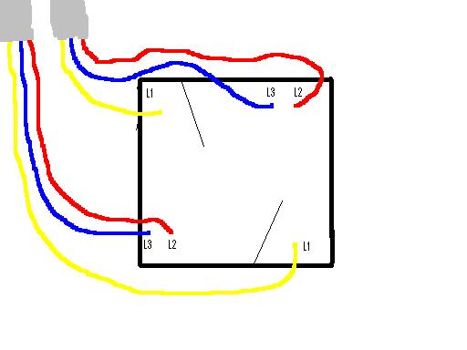

I I'm installing plinth lights in kitchen and wish for them to come on when lights are turned on.
I have a double switch at etiher end of kitchen, but do not need 1 of them so wish to turn it into a plug socket ( for plinth LED lights ONLY and will be hiden behide unit). So when the other end is turned on the socket will have power and the plinth lights come on.
When I went to change it over there were 2 red, 2 blue, 2 yellow wires and the earth was attached to the housen itself.
Wired as shown in pic so where do the wires go in a single socket that has 1x L 1x N and 1x Earth?????????? Please help.
You can't do what you're asking as there's no neutral present amongst other reasons why it's a bad idea!
Dave you can't do it.
The wires for thw switches will be switched lives from the lighting circuit.
There won't be a neutral and it's not right (even if you got a neutral) to fit a plug socket in to the lighting circuit.
I'd suggest you keep the switch and see if you can design the LED lamps to become part of the existing switch and light circuit.

1) The neutral is in the ceiling with the lights, so you'll have to get a cable from there to behind the plinth.
2) It will be notifiable.
Have a look inside the other switch if your lucky the spark may have used the switches as the loop in point. The neutrals (if they are there) will in a connector block pushed into the back of the box.
If you find the neutrals, all you have to is disconnect boths sets of strappers (the red, yellow and blues) and then reconnect one of them, with the red as live (from switch) and blue as neutral (from connector block) and the earthwire. Then fit a 2Amp switched socket outlet at the other end.
All in full compliance with regs
If the neutrals are not in the switch you're stuffed unfortunately.
Hi thanks very much for this, had a look and is set up as shown below.
don't quite understand your instructions, think I will get a guy in who knows what there doing, thanks for help.
