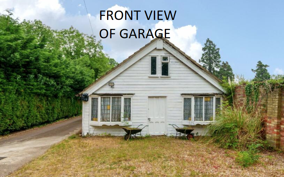

We have 0.55 acre plot with our house and an old detached farm building/garage.
It is in the country (500m outside the village). There are a few houses either side of us.
This garage is approx 1000 sq ft footprint. I have made a sketch : )
The blue line is the current boundary of existing house(E) and garage (G).
The red line is the separate dwelling boundary (approx 50m long), from garden F and back garden B.
Shared drive is D.

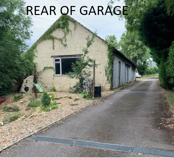

It has 2 walls of double brick and 2 walls of 'timber frame', roof is tiled.
General condition is OK - dry etc It already has connections for electric, mains wate and foul water.
I'd like to get PP for conversion to a separate dwelling.
There should be plenty of space for parking and separate gardens etc.
I believe the garage is not classified as anything so it could be considered as a former agricultural building or just classed as a garage now.
I could do a pre-planning meeting (£550) - but I think I need 1 or 2 approaches set out, first. They won't tell me what to do only comment on my proposals, right?
I think under the local plan they are ok with sound rural buildings being converted to dwellings IF they don't require re-build - so I think I need to demonstrate that the structure is good enough - so it's not 'falling down' lol
BUT maybe as a 'garage conversion' the rules are different - so a rebuild of 1 or 2 walls (if required) may not be a problem.
Any thoughts appreciated.
Just to clarify - everything inside the blue line is ours - it is our drive, our garage and our house.
The red line is our proposal - to convert garage to separate independent dwelling - we would share the drive between our existing house and the new house (former garage)

Ha ha - yes it's been built to look like a little house already but behind those cute windows and door it's just a a big dusty old garage : )
