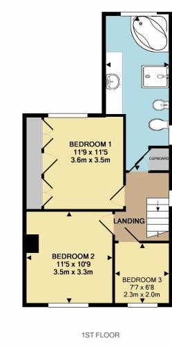

Hi,
I have began a new thread to stop confusion on my old post and appreciate your help.
Can anybody help me to see if it is possible to convert my 3 bed semi to a 4 bed please? The layout is the same other than the wardrobes have been removed from bedroom 1.
My current plan is to move the non supporting wall between bedroom 2 and bedroom 3 to make bedroom 3 into a large bathroom at the front of the property.
I would lke to convert the current bathroom into 2 bedrooms as its extremely large but all options so far seem too tricky. The narrower (original before extension) aspect of the bathroom is approx 1.7m x 2m and opens up to approx 2.6m x 3.5m. (the cupboard houses a boiler which cant be moved to a more appropriate location so will be staying put).
My original plan was to make bedroom 1 smaller to create a hallway (I know regs state the hallway has to be a minimum of 90cm).. but with the width of the original bathroom area next to it being 1.7m, this would mean creating a hallway and the width of that area decreasing to approx 1.45m.
I'm starting to think there aren't any options available therefore moving might be the only option but any feedback/ideas would be appreciated.

How is this different to the previous thread?
The bathroom is barely wider than bedroom3 and only a metre longer, you say you can't lose the cupboard and move boiler (why not?) So your have pretty much useless space there as part of a potential bedroom.
Why is an attic extension not viable?
I still think creating a bathroom between bedroom 1 and 2 is the best option. If memory serves me Scottish regs you can make it 1700wide as a viable narrowest option, imagine England may be the same.
As ash_scotland says, I think you'd need to move the boiler and remove that cupboard. Make the back bit of the bathroom into a bedroom and create the hallway to the bedroom and bathroom past Bed1 (cutting into bed1 a bit). This will all depend on sizes and other but basically, you are limited by the space. It's always going to be difficult trying to put four bedrooms in a space designed for three (the planners would've tried to create the best layout originally I guess).

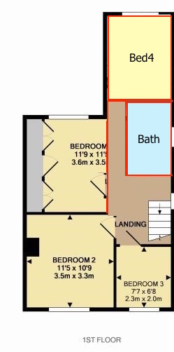

Here's my mock up! Sizes unknown?
Obviously not to scale :rolleyes:

Thank you Ash,
Sorry I put my full house floor plan on original one and didn’t explain myself properly so tried to delete post with no luck. Most recommendations were to put bathroom downstairs which doesn’t work for me so just created post with upstairs floor plan. I appreciate your feedback thank you!

The current width where you have placed the bathroom.. to put a hallway there to meet building regs would make the bathroom width approx 1.45m which I don’t think would work..
I’m guessing I’ll just have to stick to a 3 double bed..
I can move the boiler but I’ve nowhere really to move it to.
Small but doable. When I planned my extension the en-suite was going to be long and narrow at 1m x 3.4m (changed plan though). It would have to be a shower room at that size.
