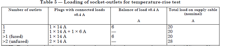

There's no confusion. A double socket-outlet is not rated for 26A, but 20A (as per BS 1363).
That's not a 'rating' - it's the current used for the BS1363 temperature-rise test.
If you were to insist that it does constitute a 'rating', I would probably have to point out that that test requires a current of 14A to be drawn from one of the outlets of the double socket - does that mean that you would say that each outlet is, individually, 'rated' at 14A?

Indeed - and I have certainly never seen, nor heard of, a fused 2-gang one. However, the temp-rise test in BS1363-2 does recognise such an animal, and requires it to be tested at 14A+6A. It's also interesting to see that it recognises >2-gang (e.g. 3-gang) unfused ones (for which it requires the test at 14A + 14A = 28A) - again something I've never seen or heard of ..
No, because it explicitly states that 14A is intended to test a moderate overload (and does not constitute its rating).
