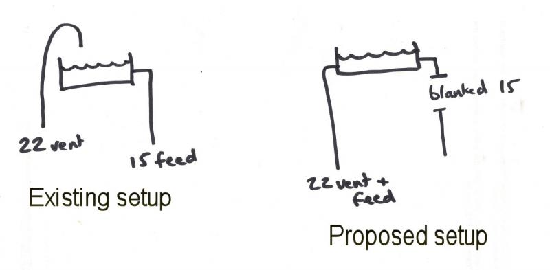

If the air is being drawn in through the vent pipe above the header tank in the loft would it do any harm if I extended the vent pipe below the water level in the tank so it could not suck air in?
With this boiler you could do a combined cold feed and open vent.
Make sure the open vent is between the boiler and pump.
Cap cold feed from tank
Connect a 22 mm tank connector to tank and fix the 22mm open vent.
You now have a semi sealed system that is much less likely to entrain air.

The 15mm and 22mm pipes from the loft tank are both in between the boiler and pump.
So, If I am understanding this correctly I blank off the 15mm feed from the tank, connect the 22mm pipe under the water level in the feed tank after having first removed the up and over swan neck part of the 22mm pipe?

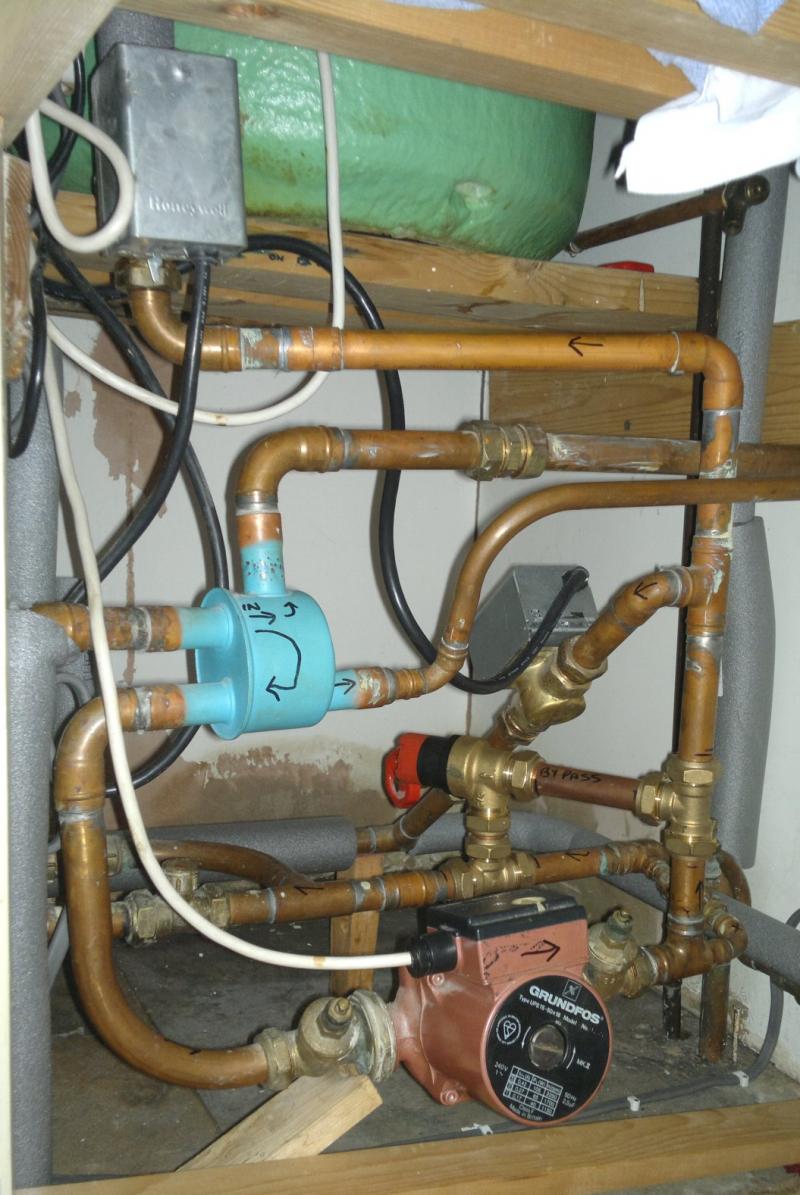

Yes, the system is in that order although the feed and vent pipes are both connected to an Airjec device.
Can I just say that we only moved into this house in April, the only work the plumber has actually done is to fit the new boiler in the garage, he is not responsible for any other existing plumbing in the house.
This shows the pipe layout in the airing cupboard .
Ignore the arrows on the Airjec, some of them are wrong.
