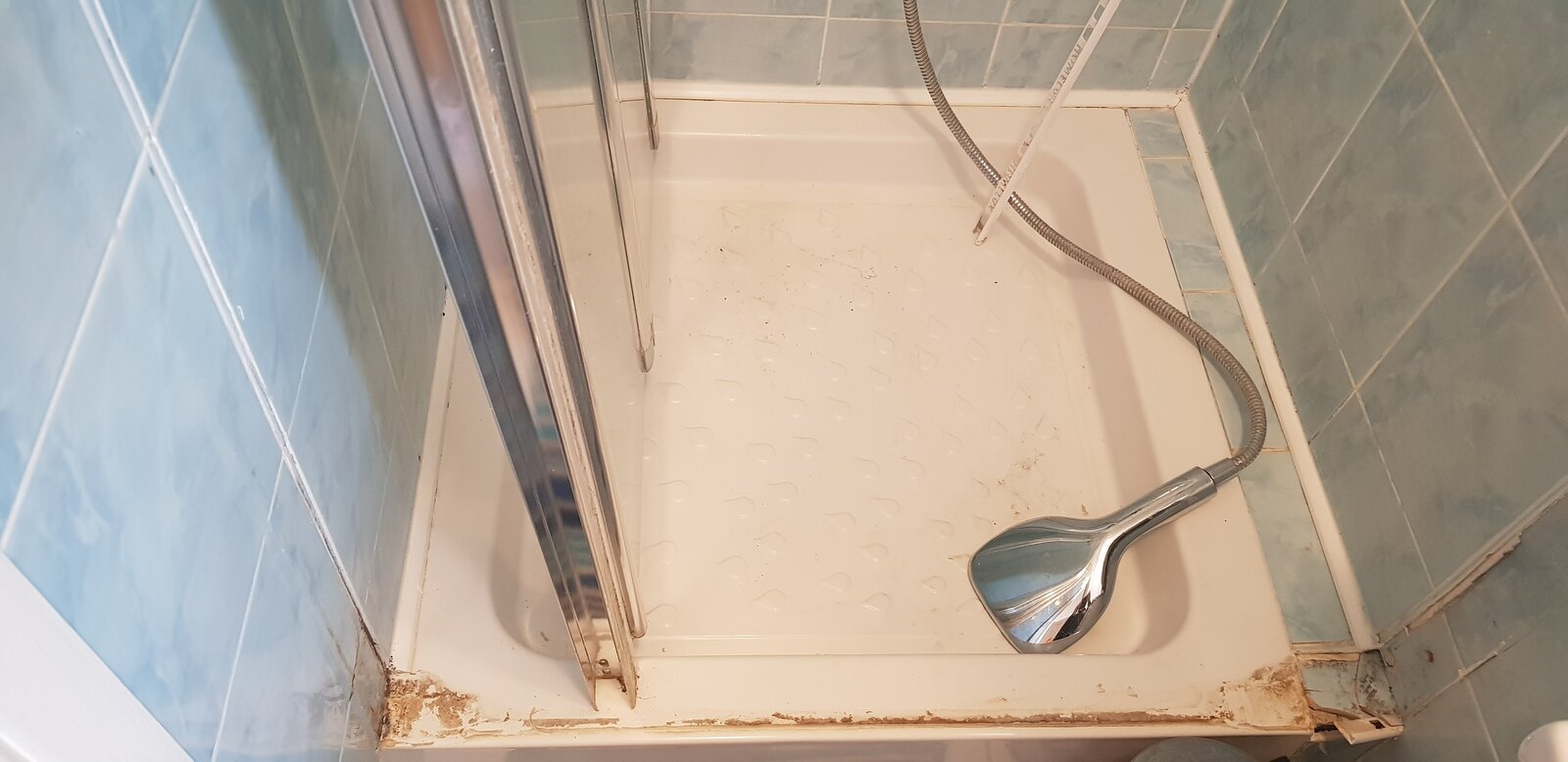

Good morning everyone,
The boss has spoken.
As we haven't used the shower room downstairs for 5 years, she wants the washing machine out of the kitchen (soon to be rebuilt)
There's a shower tray on a concrete base, so very solid.
My idea is to fill the tray with concrete so to have a smooth and solid surface for the washing machine to sit on.
I would like not to remove the tray if possible.
The internal part of the tray to be filled is 650x650, so perfect for the wm.
Any better idea or is my plan sound?

So your intention is to to fill a very smooth 50mm deep shower tray with concrete and expect the concrete to stay intact whilst the W/M vibrates and spins away like crazy?
Piece of 18mm ply to cover the tray. Tube of grab adhesive to stick it in place. Job done.
Have you considered the option of tanking it and having a wetroom-cum-laundry instead?
There's nowhere for the concrete to go.
I could grind the tray to rough it up.
I thought of that, but then I have to buy the plywood, instead I have ballast and cement left over from a job last week.

Why not Remove the tray and all items connected or surrounding it.
What you propose will be a codge, and probably look bad.
Given if you codge this what do you intend with the proposed kitchen fitting?
My experience is limited but many short cuts in the building trade lead to long run expense and irritations.
Say you insecurely "mount" the w/m, & it vibrates off the pedestal ripping off supply and drain hose when you are out for the day? Extreme but ...

The boss likes it higher.
How is broken plaster and smashed tiles going to look better than a tiled surface?
I don't know what machine you use, but anything built in the past 15 years doesn't bounce about.
Mine has been on shiny tiles for a few years and never moved, why would it move on concrete which is not as smooth?
Remember, I'm trying to retain as much as possible, not smashing everything up and rebuild the room.
"The boss likes it higher" Thats new information? Anything else that you've forgotten to mention?
Where exactly did I mention "broken plaster and smashed tiles"?
Is that what you did to your bathroom when installing the w/m?
Or is "smashing everything up" what you typically do when doing simple DIY stuff?
Nothing to be ashamed of if you are out of your depth, so no reason to get excited but you did ask for any "better idea"
Remember I'm suggesting the best solution for you in the long run.
