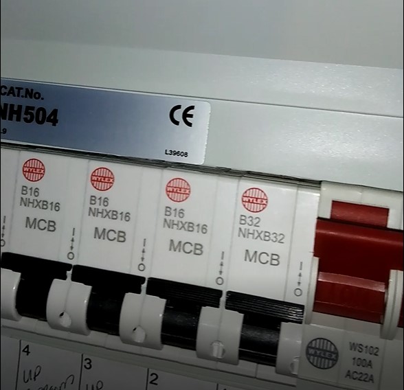

Our main consumer unit has MCBs and RCDs but the two consumer units for the storage heaters only have MCBs. Here's a photo of the storage heater CU:
Do these look like we could replace the relevant one with an RCBO? Is that something an electrician would need to do?

That RCBO should be a direct replacement, unless that consumer unit has a balcony type busbar, in which case a new comb busbar would also be required, about £10.

Close, but no Cigar, You'll likely find that board has what Wylex term a balcony busbar (strip of copper with U shaped slots in, that slide around the terminal screw on the base of the MCB), The newer mini rcbos only have a facility to fit on a PIN based busbar that goes into the rising clamp terminal. The dual RCD boards went over to the pin shaped busbar quite some time ago, where as the boards with only a single bank of circuits (either RCD main switch, or isolator) retained the 'Balcony' style up until quite recently, and they were still in the supply chain at the time the new mini rcbos came out... that caused a bit confusion!, the newer boards had the L suffix
Page 37 here: https://www.electrium.co.uk/media/20180806154618_0_WY2394a_Wylex_DCP.pdf (Its not especially clear though but the pictures expain what I'm taking about)
