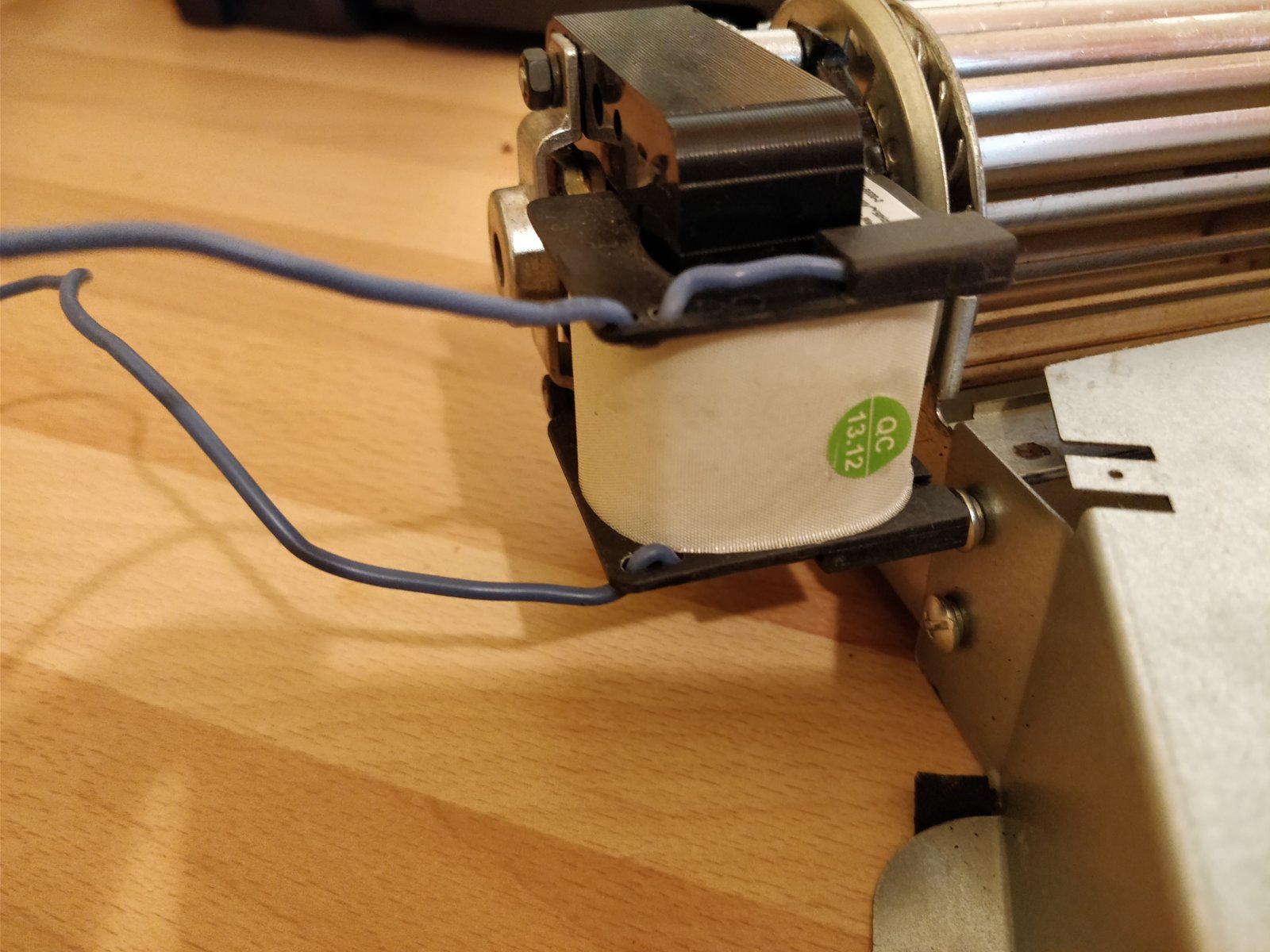

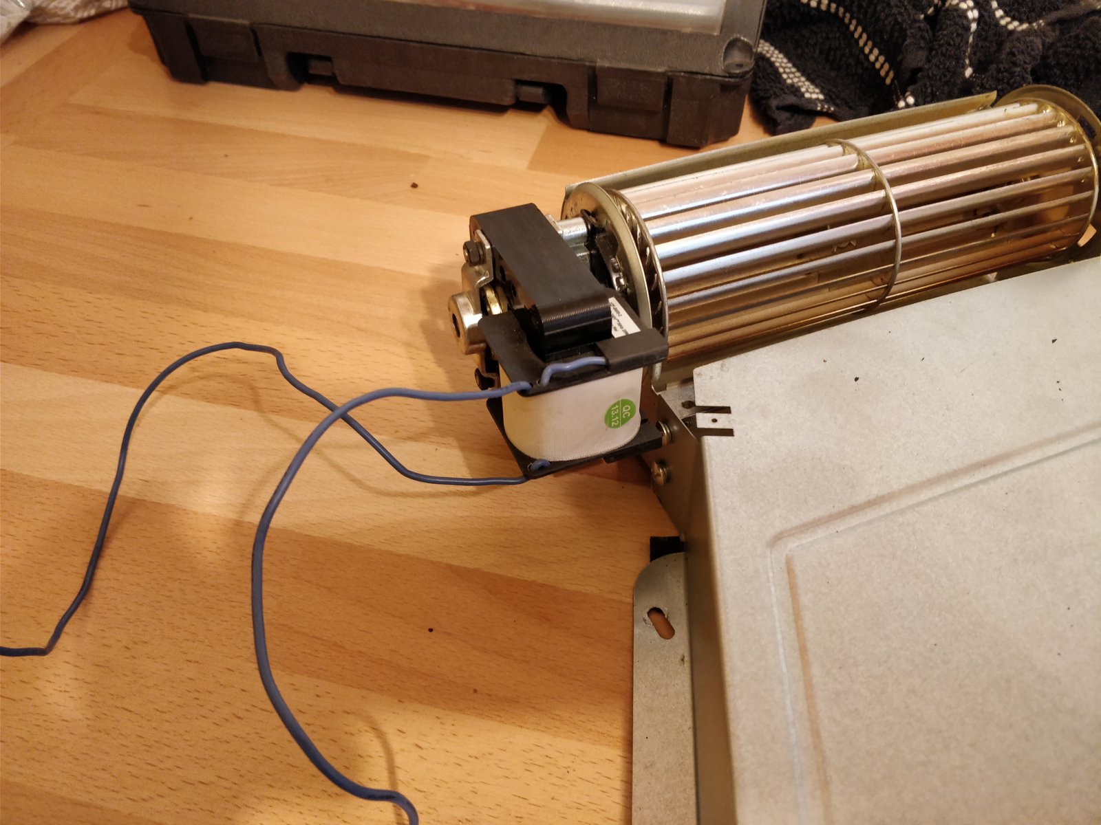

Right I got a cooling fan replacement and I fitted it, however I deleted (accidentally of course) the photo I took of the motor connections for the cooling fan. I connected it back up as best guess by the way the wires bent, and it "works" but I'm just wondering that if I connected it up reverse the motor would still work?
Picture of the cooling fan below. There are no positive and negative signs, and only these two wires go in a crimp with other wires so I just replaced. Can't imagine I'm burning down the joint, just wondered if anybody had any ideas?
I'm awaiting new crimps before I close it up and set it loose, so I have 24 hours or so to check it out.

...because its AC voltage, so there is no positive and negative.
The polarity refers to Live versus Neutral
There is positive and negative, Half the time the Live wire is Positive and the Neutral wire is Negative, the other half of the time they are reversed. The Live wire is Positive 50 times a second and Negative wire 50 times a second, hence the term 50 cycles per second ( since renamed 50 Hz Hertz in memory of the physicist Gustav Ludwig Hertz )
