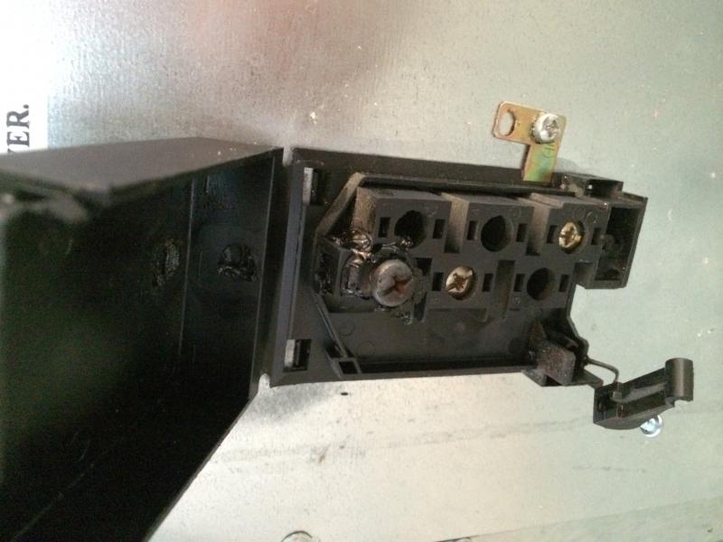

Hi everyone,
Just had a call from a relative to say cooker had blown so I nipped up there to find all the kitchen sockets had tripped as well.
Turn cooker off on the unit and isolate on the wall switch, turn everything back on at the CU and fine. The minute you switch the cooker isolator on, the cooker MCB trips as well as the downstairs sockets.
That's never right.
I thought the cooker problem could just be a blown element but I'm thinking they may be a bigger issue.
Turn cooker off on the unit and isolate on the wall switch, turn everything back on at the CU and fine. The minute you switch the cooker isolator on, the cooker MCB trips as well as the downstairs sockets. That's never right.

No. Seperated CUs. I've found the snag. I'll update later on.
Right, well I'm still alive!
To clear up the separate CUs. One is the original and when they had an extension a second CU was added and this newer one is where the cooker is and the sockets are still on the old one.
Anyway, I visually checked the element on the cooker and it looked fine. Usually when they go you get some sort of visual indication whether it's a hole, scorch etc. so I pulled the oven out and opened the plastic box on the back where the terminals are and found the live was serverly burnt. That bottom pic shows the joined wires I couldn't pull them apart!
On closer inspection, I found the neutral had welded itself to the live. So I took it off, snipped it back as luckily there were enough slack on the cable, and re-did the wires and this time I sleeved the earth as there wasn't anything on it before.
Oven works fine. It just so happens that this day, 10 years after the cooker was installed, the insulation finally gave way probable chaffing I guess.
Before I reconnected the cooker I switched the sockets on and volt checked the red and black. 0v. I then switched the cooker on at the CU and 240v was there. Bingo!
The only reason I thought for the down stairs sockets going was there is a cable behind the oven, near this box that is fed from a fuse spur of the ring main, to power the cooker hood. But it's weird that the fuse didn't go in the FCU, just the MCB. You can see the cable going across the wall in the bottom photo.
Hope it all makes sense. A little bizarre!
