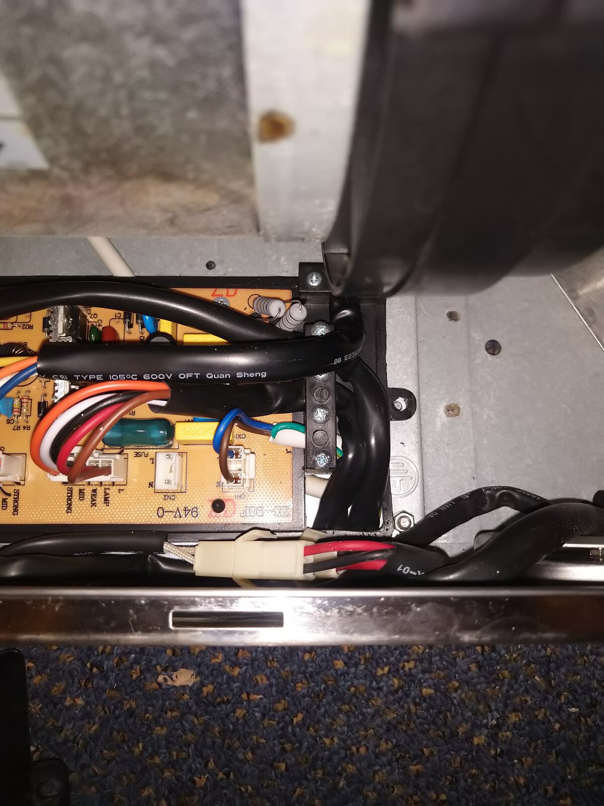

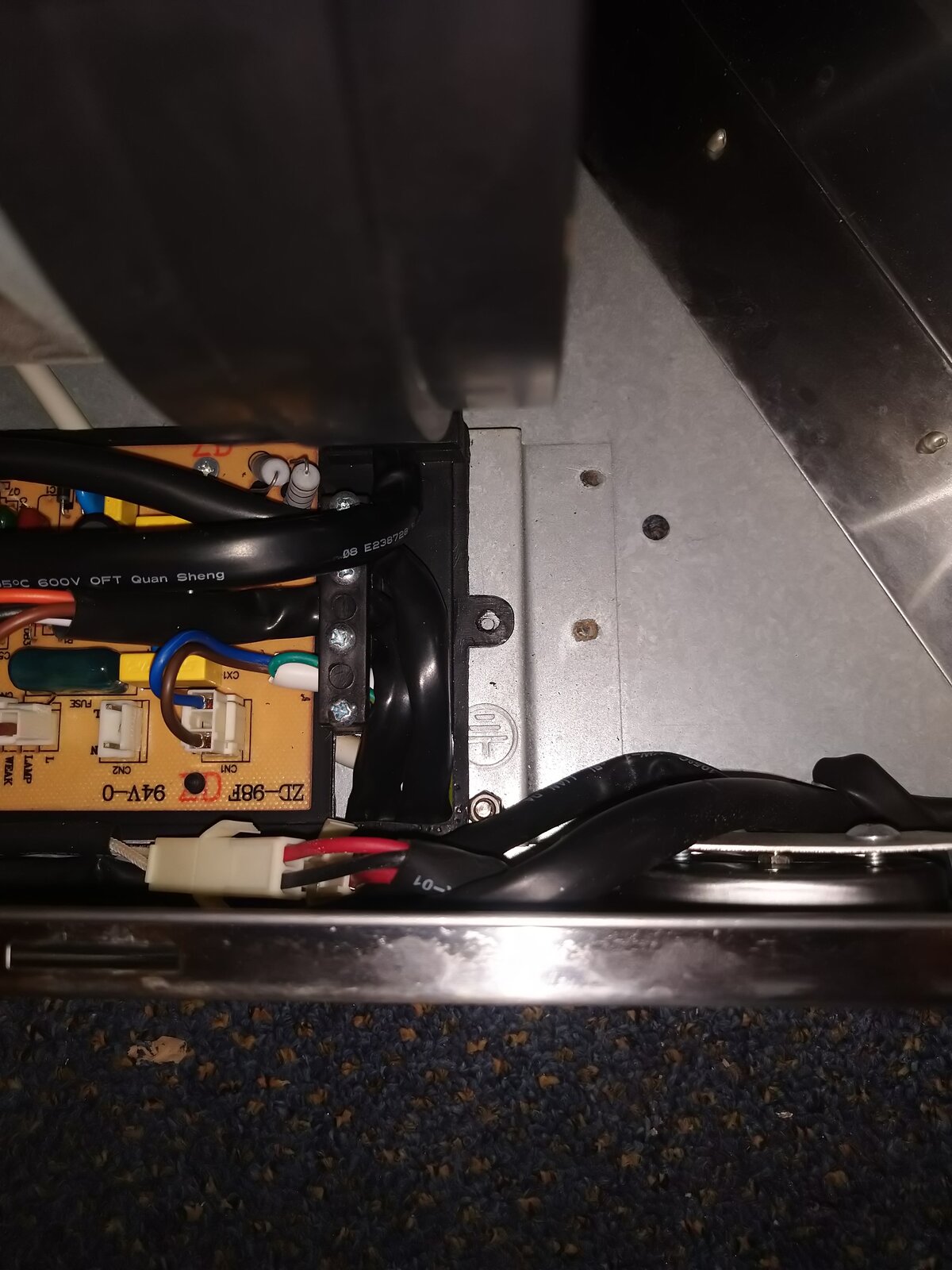

I've taken off the internal cover and the live and neutral go to the board and the earth connects to an earth point on the inside of the backplate.
So should I earth it please?
You may as well.
What happens if you do earth a double insulated appliance?
It becomes like any other earthed appliance.
It's just that DI is considered safer in the event of a fault elsewhere - i.e. won't become live.

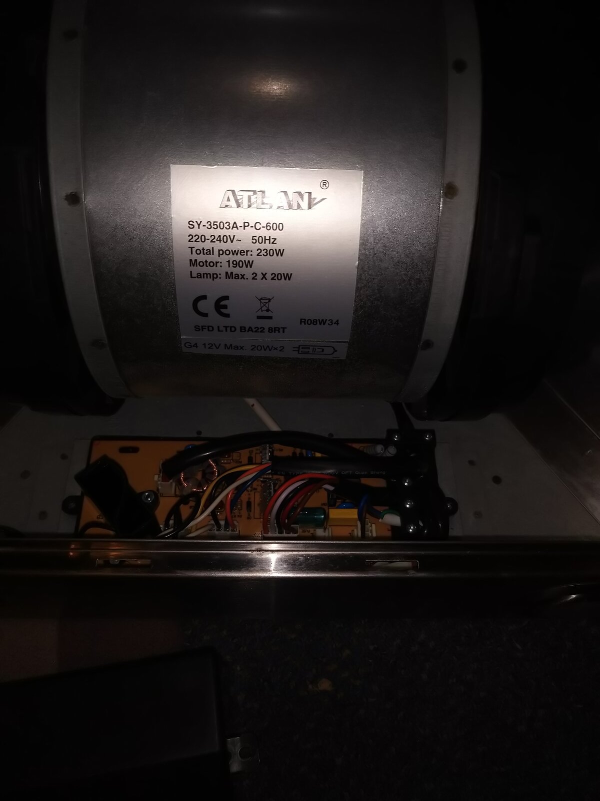

Label says 220-240V @ 50 Hz. 230W max.
But then says the lamps (2x 20W) are at 12V max...
