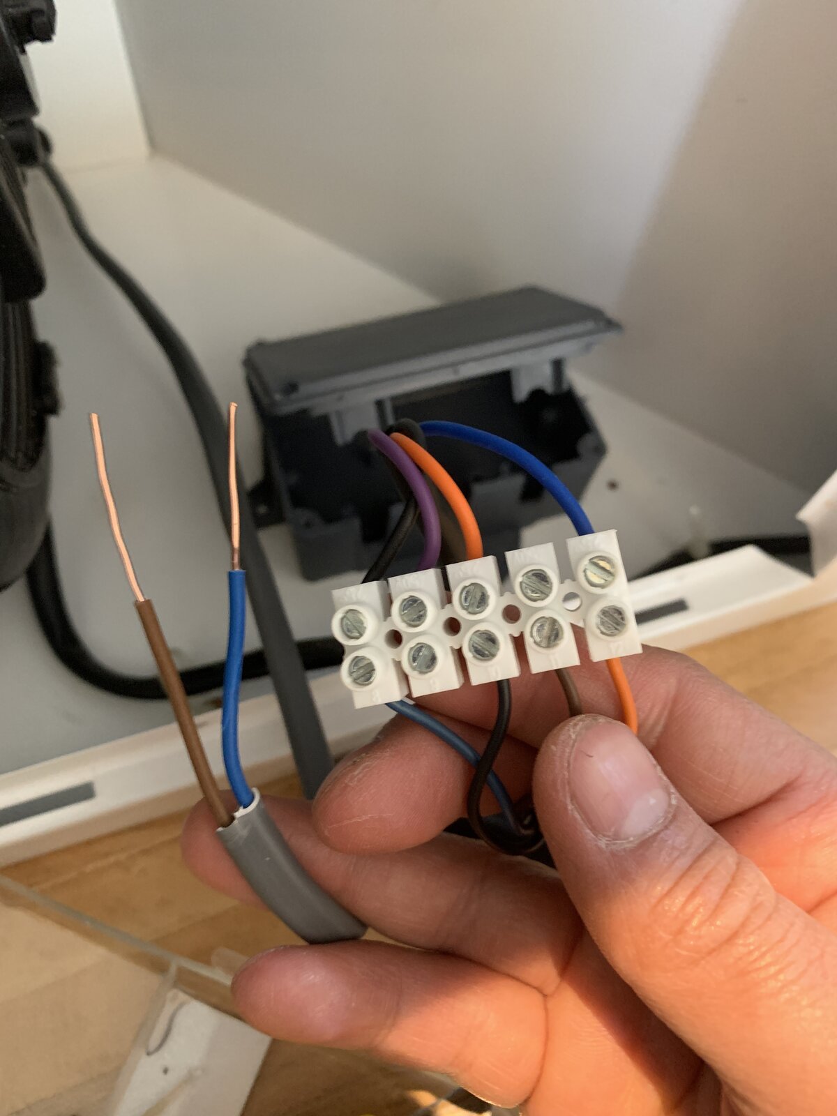

Hi everyone,
Doing the stupid thing as usual, disconnecting cable without taking photos, and now I'm not sure how to reconnect the power supply cable.
In the photo, the 4 upper wires is from the fan and the 4 lower wires is from the fan speed/lighting control unit.
Thanks for your help!
Do you have a multi meter that you can test with? It would be just a guess but I would say you need to connect brown to brown and blue to purple where you have spare ways in the connector block.
Coneect the meter across the 2 terminals I mentioned. Select resistance on your meter. Check the reading and then press the fan speed buttons one at a time and see if the reading changes with each switch.and let us know what readings you get.
@jj4091 So, for low speed, I've got 35 Ohm and for high speed, I've got over 100 Ohm. I remember both the wires from power cable is doubled up, on the same spot with some other wires though.
