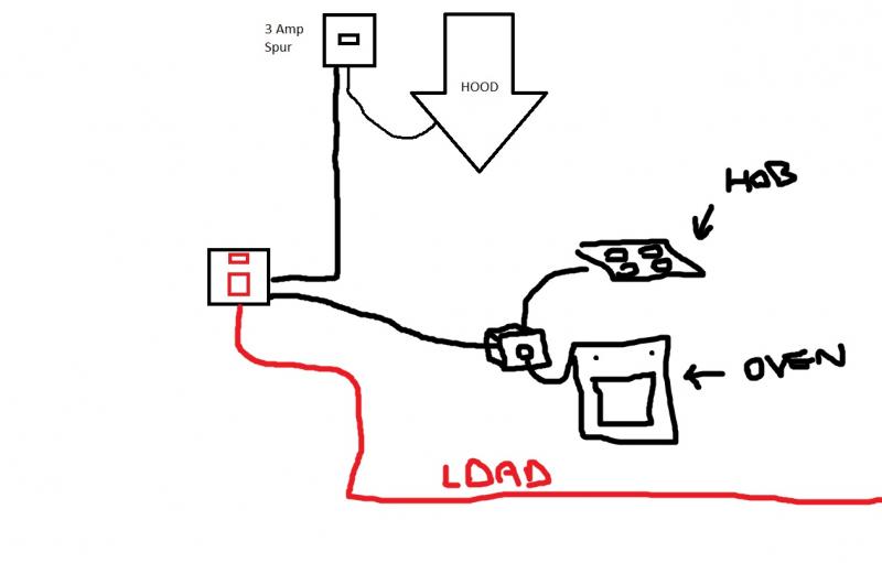

I have a question regarding possible setups in my kitchen
can i run a 2.5mm cable from the cooker control switch to a 3A fused spur for the cooker hood?
I do have the option to take it from an old feed around 3 meters away (was a extracter fan there previously) (i`m going to have to run cable along from it however which is extra work but can be done but checking on this forum to see if the fused spur can be taken from the control switch as demonstrated in the image below)
there already exists running from the control switch, a 6mm cable which has a socket (with backbox) on it which the over hooks into, the hob is also coming from the 6mm cable to power that.
also if this is an ok setup, should the hood be wired so that it is "always on" or should it be switched also using the cooker control switch?
the setup is below
cable running to the socket is 6mm and to the hob is 6mm
cable from the oven is molded plug from manufacurer.
cable to the hood is 2.5m
you need to be Part P qualified to do electrics in a kitchen, I suggest youfind and electrician to do it. in theory you are right.and use a switched fused spur to isolate the hood.

okay thanks, I just had to make sure before i done this, yes Lanarkshire is in Scotland, the circuit is actually a little different, I have a 45amp rated spur going to the hob then a socket with backbox at the end of the circuit for the oven, plug for oven is molded.
