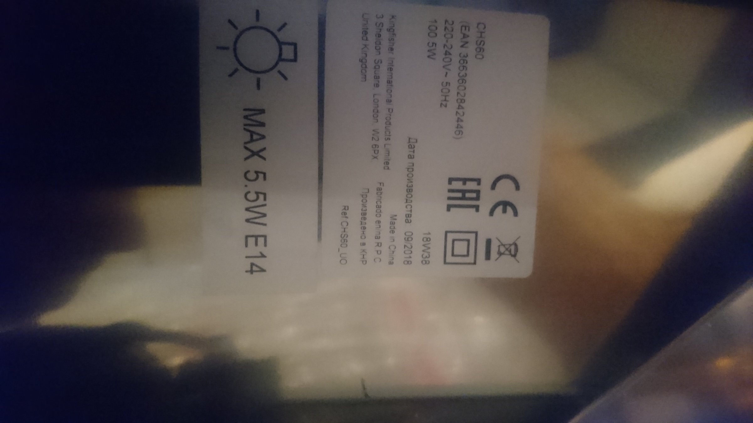

So i just picked up the hood in question and the leaf only has a live and a neutral. No earth.
Its this still okay for use with a 3 pin standard plug?
It means it is double insulated (or has reinforced insulation) and does not require earthing.
This is considered 'safer' than earthing.
It is claimed to be double insulated and so suitable for not having an earth. Just connect the two wire that are present into the plug.
