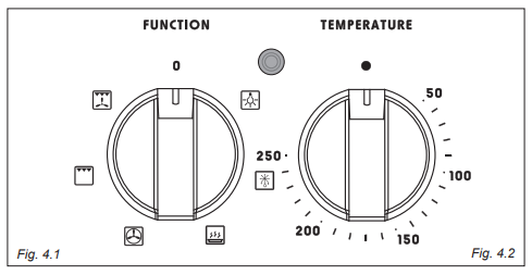

Hi, I have Kenwood CK406SL cooker with gas hob and two electric ovens. Its less than 2.5yrs old.
In main oven, when I turn-on the function knob and then as soon as I turn the temperature knob its tripping the MCB.
This doesn't happen with the smaller oven and it works fine.
Cooker has dedicated circuit to the CU and it is has cooker socket on the wall with the switch. No other appliances are connected to this circuit.
Electrician has tested the cooker circuit to the CU, Cooker Socket on the wall and the cable from the cooker to the wall socket. He said there are no issues, nor there is earth leakage problem.
I have been reading on this forum about similar issues, where some points out to the oven element or to the oven light or to the thermostat. Is there a way to troubleshoot on what is causing this?
If we take oven element out >> Can I then turn on the oven to see if MCB trips or not?
OR may be take bulb out and turn on the oven to see if MCB trips or not?
Any help on this would be much appreciated, thank you.

As I read it, things are OK when you switch the oven on and it only trips when you turn up the thermostat (temperature control) ? That narrows it down to the main element in the oven affected - or one of them if there's multiple elements.
A common fault is for moisture to get in. These elements are resistance wire embedded in mineral powder packed tight in a metal tube. The mineral is hygroscopic so if an end seal fails then moisture is absorbed and the insulation becomes a little conductive - so you get leakage current that trips the RCD.
As mentioned, disconnect the suspect element, insulate the wires, and you'll probably find the supply doesn't trip. Then replace the element. Don't forget to switch off at the supply before delving into the wiring.
The other possibility is a wiring fault (e.g. chafed insulation allowing an internal wire to short to earth).
