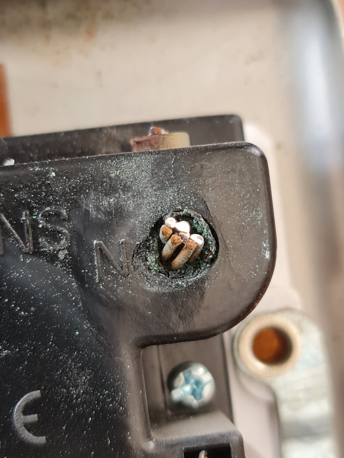

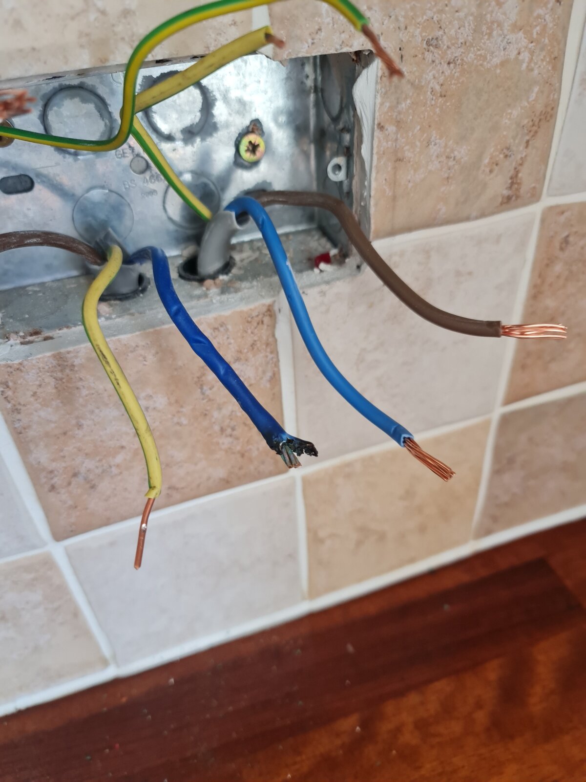

My mum asked me to swap out her cooker switch & socket because the red plastic windows for the neons had fallen apart.
I noticed that neutral on the supply side had melted slightly. so much so that the head of the terminal screw snapped when I was trying to undo it.
I had to cut the cable to remove it. And then used wire wool to remove the oxidisation from the copper.
The circuit is on its own 20 amp (RCB protected) MCB. The supply feeds a combi/microwave oven and a single fan assisted oven (the hob is gas). She occasionally uses her toaster on the socket side but says she has never run all 3 appliances at the same time.
Is it anything to be concerned about? I would guess that the socket was 8 years old.
