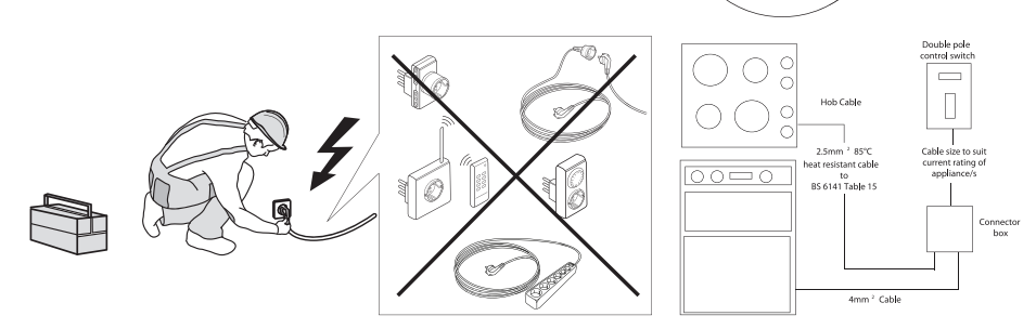

Right. As you say, it is said to be "20A", which I assume is the maximum current drawn. After allowing for 'diversity' (which takes into account the fact that all bits of the oven will not be drawing current for lengthy periods of time), that can be regarded as a current of 13A - hence 'just' low enough for 13A accessories (like plugs and sockets, and FCUs) - and the ('wordless') installation instructions appear to show it being 'plugged in'. Do I take it that it didn't come with a cable with a plug on the end?
Having said that, the 'exactly 13A' (after diversity) is pretty marginal, so I would not personally be too keen to 'plug it in'.
Are you sure?
Are you sure?
Not at all - these wordless instructions drive me mad, and I think (as witness this incident) are potentially dangerous.
Now you raise the issue, you're probably right (in implying that I was wrong!). At my initial look, I thought that the drawing on the left (which is NOT 'crossed out') was indicating a man ('legitimately') 'plugging it in', and that the crossed-out bit in the middle was indicating that it should not be used with extension leads, plug in timers or WiFi switches etc. ! However, now you've made me reflect, I agree that was probably the wrong interpretation.
In an event, what are your feelings about the fact that the after-diversity load is exactly 13A (if the 20A is at 230V, but <13A if, as is probable, the 20A relates to 240V)?
Kind Regards, John
