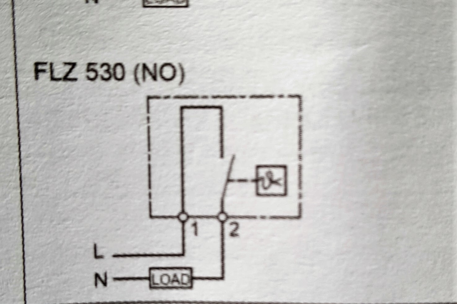

Can someone back me up with this issue, I have what claims to be a N/O Thermostatic Switch that I intend to use to extract warm air from an AV cabinet. The infro from the RS website and the Data plate confirm that it is a N/O type.

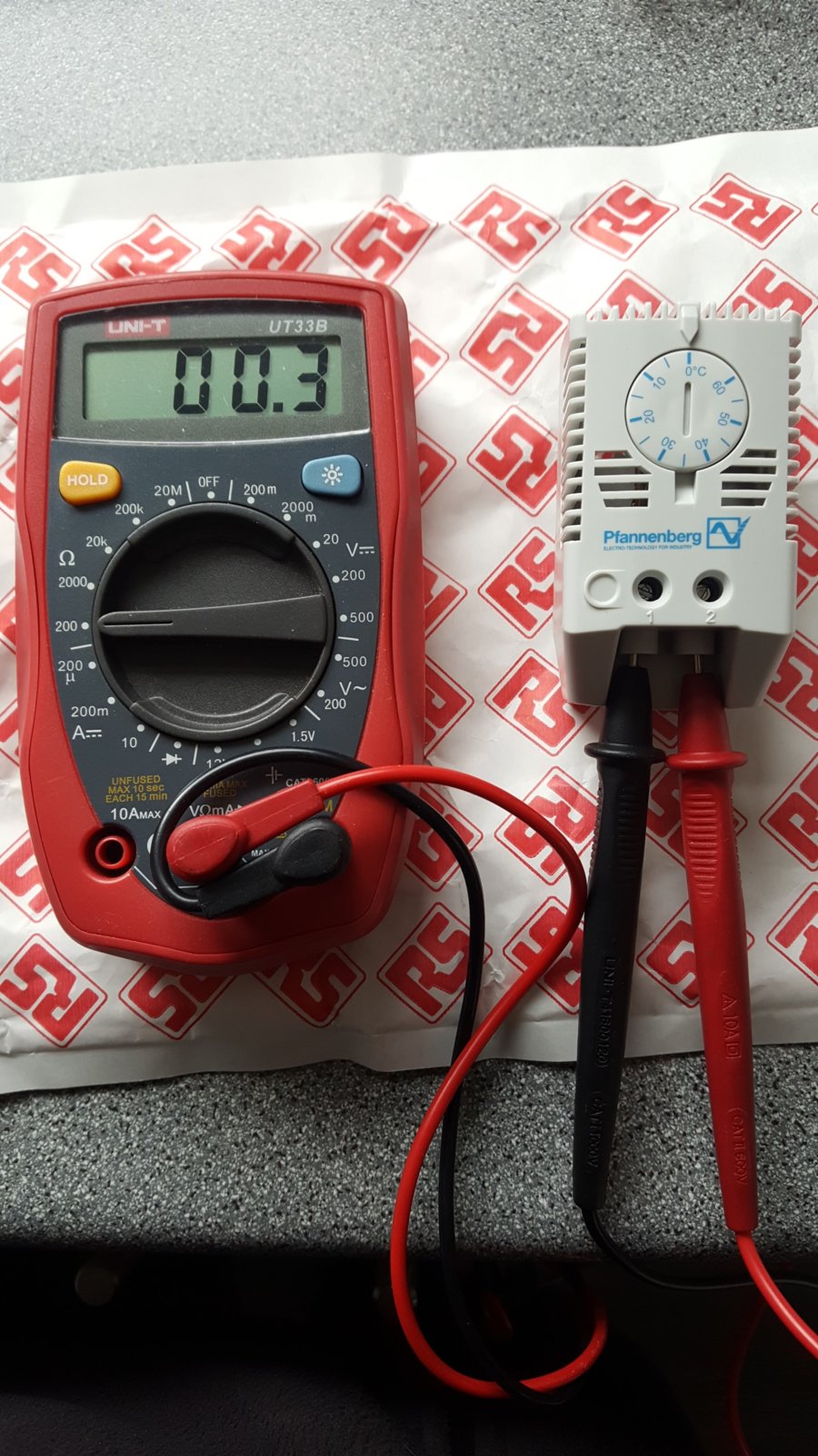

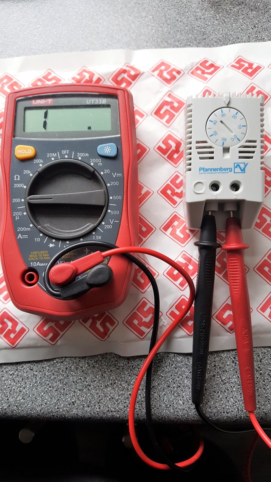

However, when set at 0 degrees C, the contact is CLOSED and as I turn the adjustment upwards it OPENS at what I am assuming is the ambient room temperature.
My aim is for the cooling fan to operate as the temperature in the cabinet reaches a set level, so therefore I require a N/O Thermostat Switch that will CLOSE at that set level and turn the cooling fan on.
Am I correct in my thinking, if so it appear the so called N/O switch I have is really a N/C version with the wrong info attached to it.
