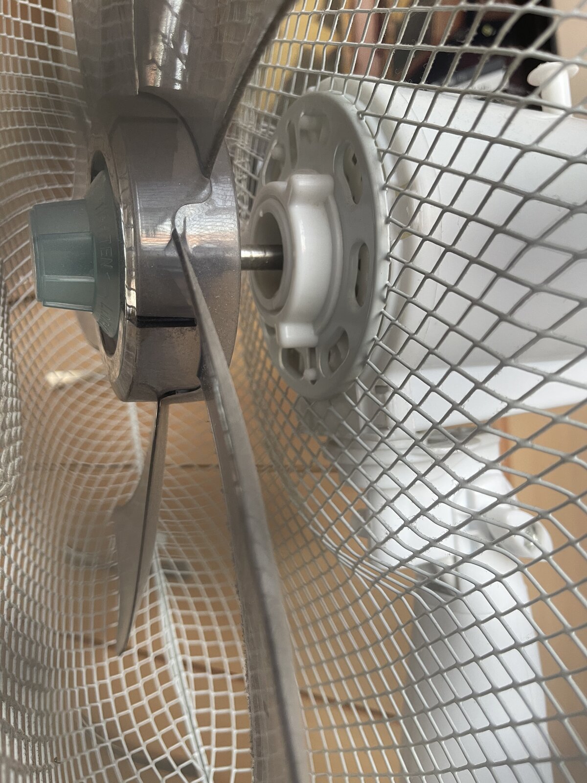

Thats a picture of my fan. There is some dust around the metal stick that turns. Should I clean everything and them reassemble it again?

Take the front guard off (swivel the tabs, there may also be a small screw), take the blades off (unscrew the blue end cap clockwise!), and you should then see one bearing where the shaft enters the motor.
Dribble a little oil down the shaft into the bearing. 3 in 1 should do, but it depends what you have to hand :)
...also removing the rear guard may give you more access to the front bearing.

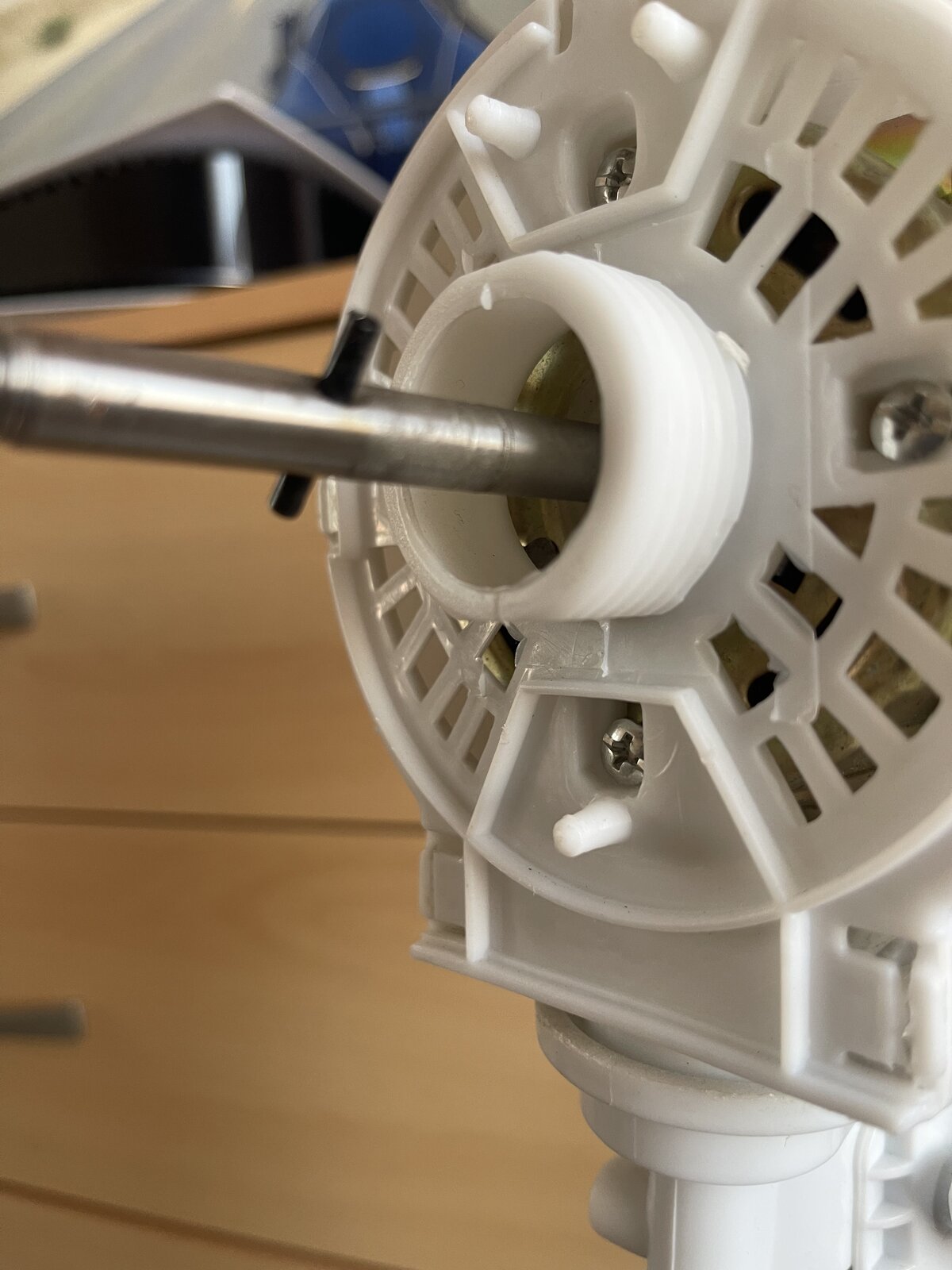

Is that black thing the bearing?
If so would it alright to put any sort of oil?
I have a wahl hair clipper oil, I assume that would be fine?
Can't see a black part!
First I'd have squirted WD40 onto the shaft and let it run towards the bearing under gravity - sometimes you get lucky.
From where you are now I'd undo the 4 screws. Fair chance the front bearing will be fixed to the bit you will then be removing, then you may be able to remove the shaft with the central part of the motor revealing the rear bearing. The clipper oil is light enough to dissolve the grease over time to make it work as grease again, so try a few drops.

I cleaned the blades etc. and ran a bit of oil into that black plastic straw thats going into the metal bit.
Has improved by doing that.
