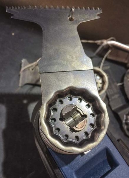

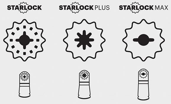

Assuming that you have a Fein AFMM 18 QSL cordless (you didn't actually state the model) then your Multitool is StarLock and StarLock Plus compatible. That means it will take compatible cutters from Fein or Bosch (who jointly developed the standard)
The standard is very new, having only been announced last year and only really appearing on tools at the beginning of this year, so to an extent you are paying the price of being an early adopter, however with the two most important manufacturers of this type of tool (Fein - the inventors and original patentees and Bosch) behind this standard the market will not be long catching up.
AFAIK Starlock accessories are backwards-compatible with Bosch OIS-compatible tools including:
  • Bosch GOP
  • Bosch PMF
  • Fein MultiMaster
  • Fein-rounder
  • Makita
  • Hitachi
  • Metabo
  • Milwaukee
  • AEG
  • Einhell
  • Ryobi
But Fein's own information on this is that the AFMM 18 QSL should be backwards compatible with older Fein-compatible blades such as those supplied by Saxton. Have you actually tried any of those blades? Or have you contacted Saxton to ask them about compatibility?

Had an interesting chat with the rep from Fein today...... The newest Bosch and Fein tools are all coming with this new standard. The new cutters were introduced 3 months before the tools were released and most of the old tools can all use the newer cutters (Starlock and Starlock Plus at least), BUT, the new tools can't use the older cutters. Other manufacturers may well come into the fold (hints at next year), but there is no intention to allow the cut-price blade makers such as Saxton or Faithfull to use the newer (patented) cutter attachement standards. It will be up to 3rd party firms to produce their own adaptors without infringing patents. Seems like your original premise is right and that they are trying to carve themselves a closed market.
