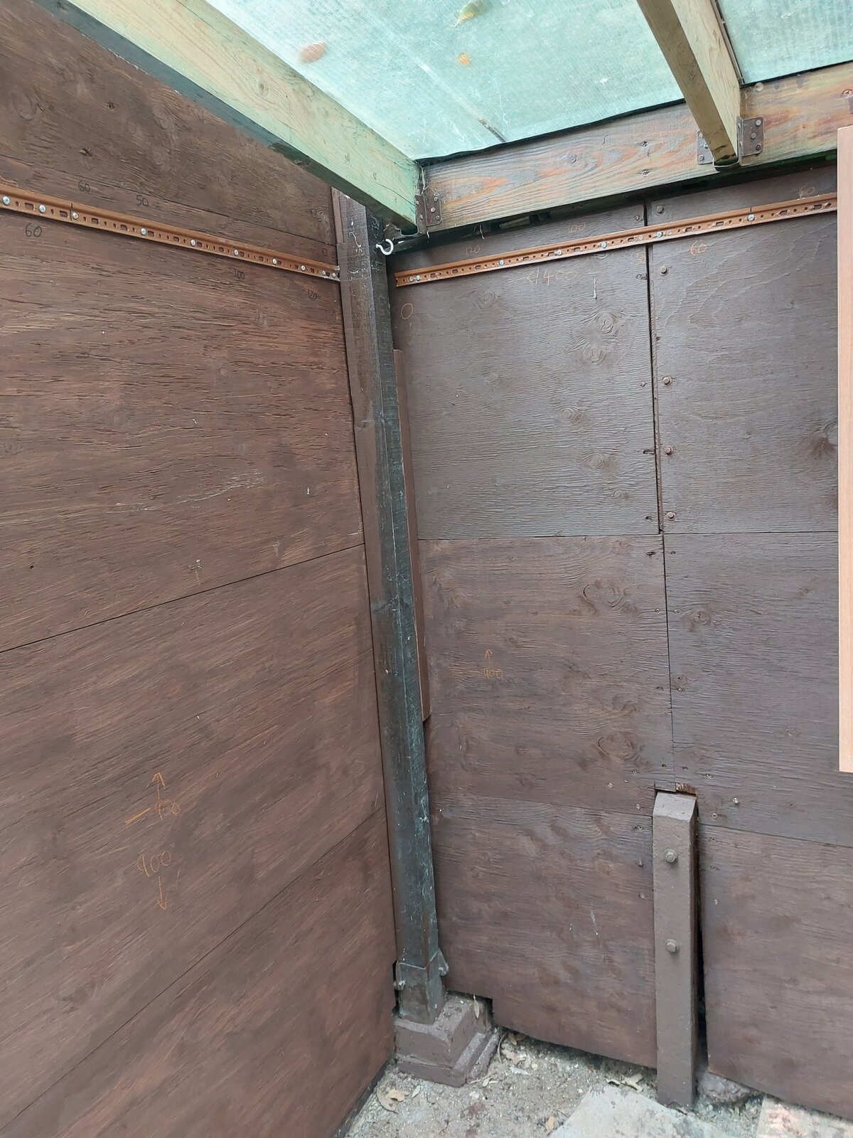

Instead, pour a concrete pad for each support. 1 ft deep, 1ft square, and rising out of the ground by 6 inches (wooden formwork placed in the top before pouring will make it look neat) and use steel post supports, either cast in place or bolted down. Pic below shows example in corner Somebody will complain that they are clumsily done. I got better with practice
Paint the steel thoroughly before placing. I have a example one I dug out that rusted away like tissue paper.

Another method is to put a concrete spur in the ground, and bolt the wooden post to it (also example in my pic).
People who have had to replace rotten posts set in concrete take great care to avoid doing it again.
You will bolt it to the frame of your decking which will hold it upright.
