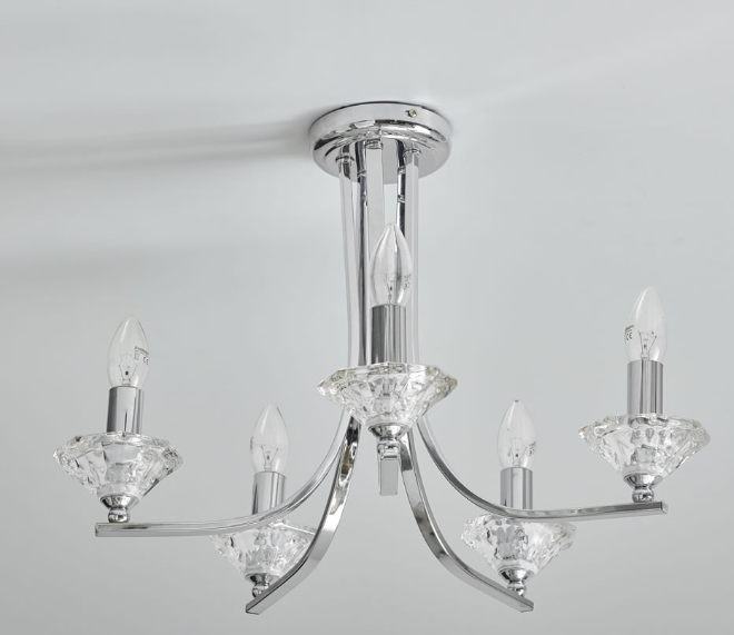

Can anyone advise which dimmer I need to buy from these 2:
https://www.electricalcounter.co.uk/products/Switches+&+Sockets/Nexus+Metal/Nexus+Metal+Brushed+Steel/Metal+Brushed+Stainless+Steel+1+Gang+(1G)+2W+400W+Dimmer+Light+Switch/73248417
https://www.electricalcounter.co.uk/products/Switches+&+Sockets/Nexus+Metal/Nexus+Metal+Brushed+Steel/Metal+Brushed+Stainless+Steel+1+Gang+2W+400W+LED+Dimmer+Light+Switch/3943339581
One switch will be used in the living room with a light fitting, I will purchase dimmable e14 bulbs to go with the fitting. This light fitting http://www.wilko.com/ceiling+wall-l...rome-effect-ceiling-lightfitting/invt/0326075 :
The other switch is going to be used in master bedroom which has downlights, I will purchase dimmable gu10's.
Just wondering which is the correct dimmer switch for each room from the above.
Many Thanks
Thanks, I asked the store too and they said they are both the same. They also said:
'They are both led compatible. When purchasing your lamps please ensure they are leading edge compatible if they are trailing edge then you will experience flickering, buzzing and they will eventually pop.'
So I guess I need to get leading edge bulbs, so I will need ses and gu10 types.
From a quick google mose dimmable bulbs are compatible with both leading edge and trailing edge dimmer switches, or am I mistaken?
