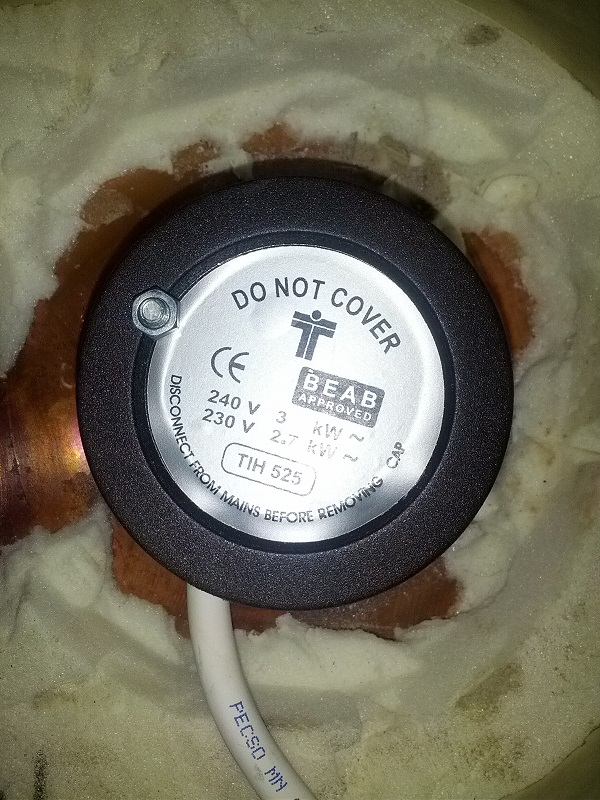

Hello
I've had a new hot water cylinder installed along with new immersion heater. Not sure what size the immersion heater is, but I suspect it's far too small (perhaps 11") because regardless how long it's operating for, I only get quarter bath full of hot water before runs cold.
What's the correct size immersion heater for 1050x450 cylinder, 27" or 30" please?
Thank you
Sorry, should have added, it's top entry. So will 27" heat up whole tank? I wish I had a look (or even kept) the old one now as that did heat up whole tank.
One last thing, how are they measured please? Is it the actually element that measures 27", or the unit as a whole?

It'll heat the whole tank mate.
From the boss to the end of the element.

Data plate on the top of the immersion may contain details of the length.
Have a look or pop a picture up of it and we'll have a look.

Here you go...
Tesla TIH 525 is a 27" Immersion heater.
I would get the original guys back out as there is something amiss. It would appear that the element is shutting off prematurely for some reason, possibly stat related or the element is faulty from new.
A few electrical tests would diagnose the issue.

Silly question but in your OP you say that you only get a quarter of a bath of hot water before it runs cold but how big is your bath? A 1050 x 450 holds about 140 litres but not all of this will be hot as cold is mixed in as its used. From a 140 litre cylinder I would expect to get about 100 litres off it before you noticed a substantial temperature drop maybe less.
Rather than a quarter of your bath can you measure or work out how many litres you are actually getting off it?

Thank you. They did perform an electrical test the last time, and they said everything was fine... but clearly something is wrong. Think I need to just literally show them how much hot water I've getting after running a bath.
Yep standard bath size, so I'm getting roughly 35 liters before running cold. As said old immersion heat heated up full tank, but new one just not managing it.
Ok well i would suspect a faulty immersion or stat from new. Being a new install it would take them less than half an hour to swap it out to a new one.
35 litres is a lot less than I would expect to get from it.
Keep on at the original installers as there is obviously a fault and any DIYing will stop them attending to rectify.
