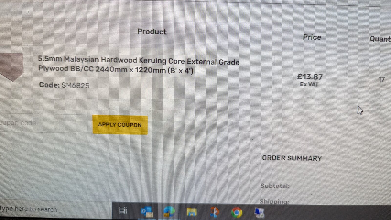

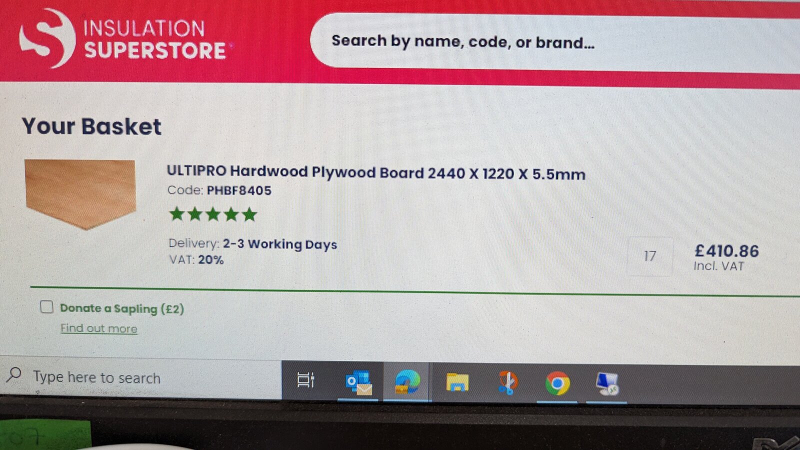

I'm not sure if I'm looking in the right places but I'm struggling to source SP101 or FG1. What I have read some where on this forum what is a good substitute is Malaysian ply ( see pics below) and I've also found a brand called Ultipro which is apparently flooring grade.
Do either of these look like a suitable alternative?

View attachment 313821View attachment 313820
Neither of those are the same spec as SP101 which is widely available but more expensive.
