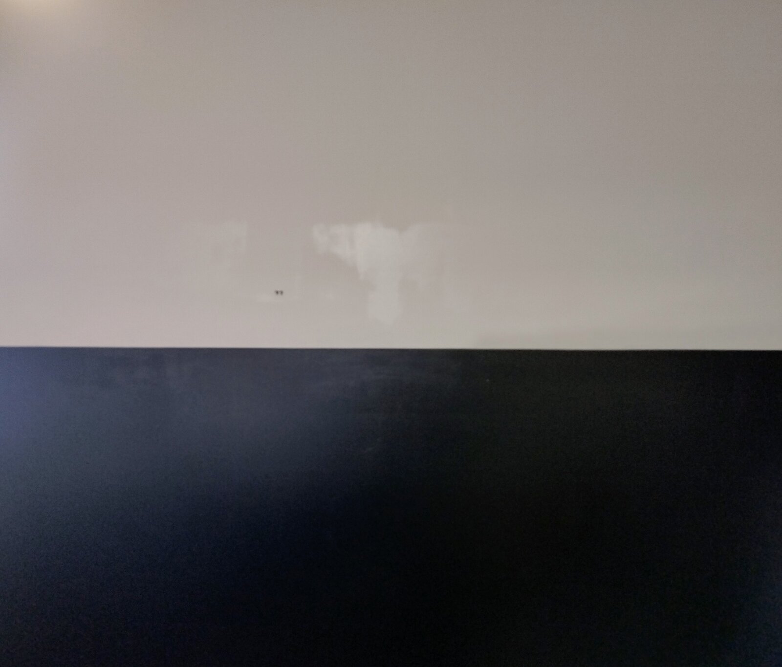

Opps you're usually right on the money..
But I have to disagree with you on this one..
The oil based satin finish looks so tasty.. I couldn't be more pleased with the outcome :D:D
Pic was while both the black and white paint were drying
To quickly get rid of the smell, I used an Ozone machine..
After 12 hours the smell was barely in the room.. After 36 hours the smell was non-existent
Thanks for the help and comments guys

I must admit, that I once painted my kitchen walls with oil based eggshell. I started of by lining the walls, applied two coats of acrylic primer, sanded everything flat and then followed up with 4 coats of oil based eggshell (sanding between coats). I absolutely loved the finish, it almost looked like a sprayed finish. It was so durable that you could scrub it with a green scouring pad.
Regrettably, over the years it did discolour, the walls that got direct sunlight were noticeably darker than the ones which didn't.
BTW, I am genuinely impressed with your wall. Kudos.
