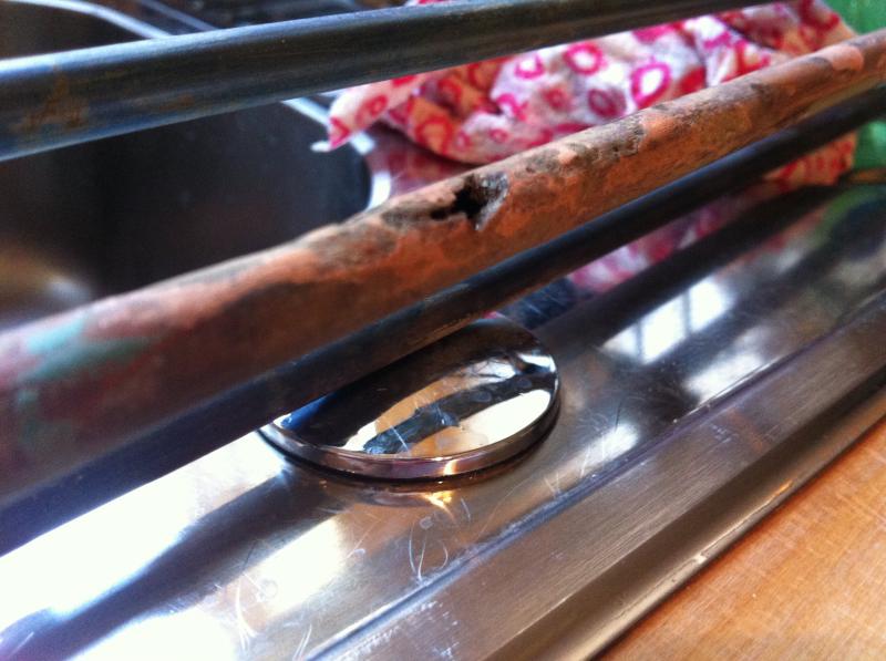

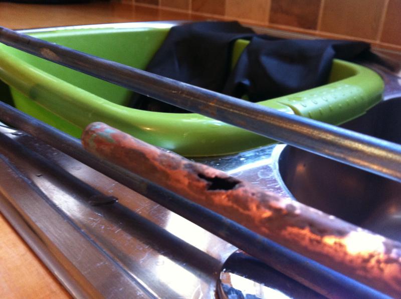

Hi, Im having a bit of an issue with my immersion heater. In the last 4 months, I have gone through 3 immersion heaters (all titanium ones). The sleeve where the thermostat sits in is literally rotting away with a month or so resulting in hot water rising out of the sleeve, into where all the wires are and spilling over the sides. I have added some photos in my album for you all to view, so you can see how bad it is. There is pitting and gauges all along the copper sleeve. Does anyone have any idear what could be causing this?

Could that be down to a faulty earth connection? I forgot to mention, in the pictures I uploaded I had cleaned the copper sleeve. It was covered in a bluey-greeny crumbly residue when I pulled it from the tank.

Never seen a stat sheath corrode like that. :eek:
Do you have very soft water?
