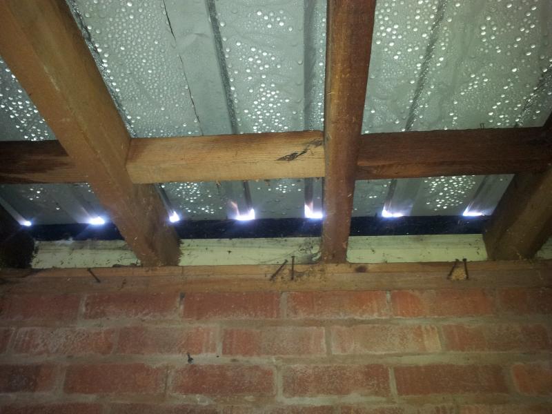

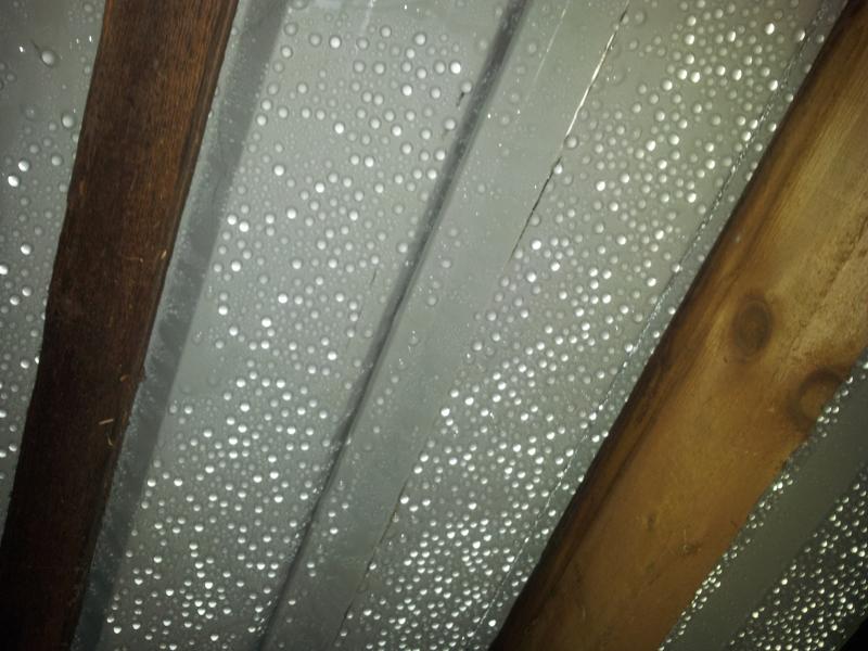

Hi fellas, thought I'd throw this one out there and hopefully get some decent advice.
Here goes.
I have a major condensation problem with my Garage roof due to it being made with box profile steel sheeting.
Replacing the Roof with EPDM etc is NOT an option so looking for a remedy.
I have done alot of research on this and making it a cold roof seems the answer so I am planning on sticking 50mm polystyrene boards up leaving a 50mm air gap with a membrane below the insulation.
Do I have the right idea here? would this cure my problem??

Not sure about putting membrane under the rafters- assuming you've got some sort of ventilation under the tin sheets I think you'll be better off with something impermeable like B & Q tarpaulins (so that warm air carrying water vapour can't get up into the insulation). But the whole condensation sketch is littered with pitfalls...

I have a very similar situation......I have put particle board on the rafters, and nothing between that and the steel roof, and I have the soffits open (just) at the gutter end.
No rot after 10 years, but the rafters were tantalised originally so it wouldn't be any big deal anyway.
It's an excellent roof covering you have, but in the winter there's bloody drips everywhere without some sort of ceiling.

Suffer from condensation? I'd say so.....my garage is a concrete panel pre fab, steel roof and in winter time is like it's raining once the frost lifts :p
If that product of yours works it could well be worth a try.....at least it can't do any damage where it is!

The advantage of that spray-on goo is it won't do any damage (whereas if you end up with lots of water trapped near the joists they might rot out). Another option might be (though I'm sure there are cons to this idea) spray the tin sheets with expanding foam. Dunno if it would stick though and it would probably look really ugly.
