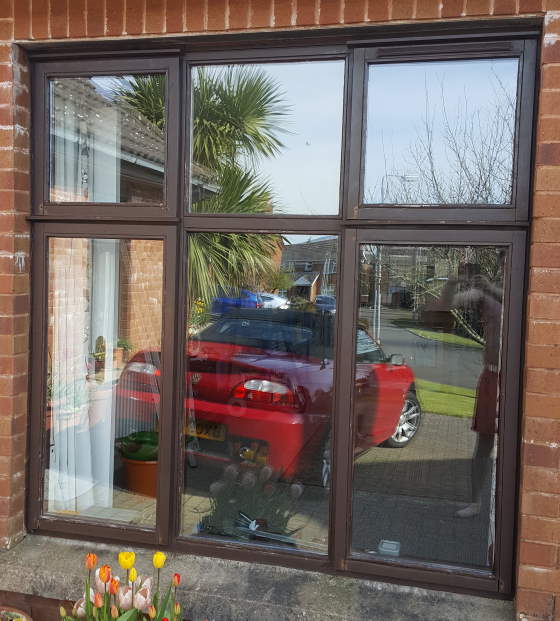

For once I'm going to recognise my limitations and not even contemplate doing this myself, so I asked somebody I know for a quote, and it seems a lot, but as I say, what do I know...
The pic below is the existing unit, in mahogany, and I'm looking for a direct replacement in UPVC. Both the side panels open (top and bottom, so 4 openers total), and the centre units are fixed.
He quoted £1000 fitted - is that reasonable? He is a proper D/G fitter. On a tight budget here as usual :sick:
Then the girlfriend suggested just getting a frame with no openers at all, as we never open them in that room... presumably that would be a lot cheaper, but not sure what I think about it :confused:
The frame is approx 178 x 178 - thanks :D
Mates rates or retail? Retail sounds about right. Looking at the picture I think height of the window it requires toughened glass at the bottom ( below 800mm from finished floor ).
As goes no.openers, technically that's a building reg fail, as you can not make ventilation any worse, so no Fensa/Certass company should entertain that BUT depends what your other windows look like as once it's removed , whose to know? But if the other windows are of a similar style an inspector could pick it up ( not saying they would or it would even get inspected , but that's yours and the guy fitting its risk.
Also Mahogany upvc frames are getting harder to get ( I only know of one extrusion company that still makes it , might be more ) , so it could be Rosewood, they like similar but also look different , if you get my drift
Id guess thats a £400 window.
It looks likes its got no cill so you would need to order one with face drainage

£400???
You are having a laugh! I couldn't even buy that window trade in mahogany for £400 with 4 openers and toughened glass!
And not all windows fitted behind the reveal were old box sash, some people still measure to get the frames behind the reveals like they would be when put in new
Its fitted behind the external skin, so my guess it was a sliding box sash originally
or following London practice after 1666
Door frames also commonly set behind the outer bricks, and not just in and around London. Older London houses commonly have no internal window-board, and have a stone cill to the outside to throw off rain and prevent it soaking into the brick. Provincial architects and builders often copied London styles, but later.
£650 on an unknown website, supply only inc, VAT. But a known brand and supplier is worth a bit more, and then fitting.....
Could make some dummy sashes, save a few quid.... when I did this it was £50 off per dummy.
Thanks for all the info, guys. So if we take the price of a half decent frame from a Grand, is what's left about right for the installation?

by the time the cost of disposing of the old one, a survey visit, fensa registration cost, allowance for warranty, materials etc - fitting one big window has to be in the £300 to £400 installation cost.
Hey, if I only knew what that meant...
If you look at your window from the outside -you cant see the whole of the frame, some is hidden behind the outside skin of brickwork. That means the only way to fit is to chip off the plaster reveals to fit a new window the same size, then replaster
or fit a small window that can be fitted from the outside.
