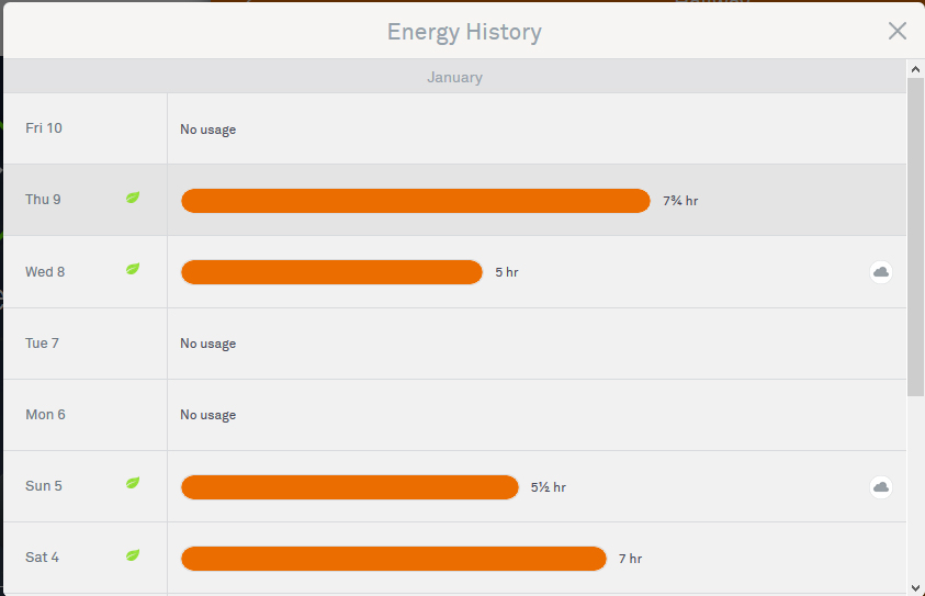

Since boiler supplied from a FCU can't use a plug in energy meter to monitor how long it runs. The Nest report
Says I didn't use the heating Tuesday and Monday that is clearly not correct. And even if it was, it shows demand for heat, not the boiler running, the boiler switches off/on when heating the mark/space ratio will depend on how many electronic TRV heads are calling for heat.
So is all the geofencing or occupancy detect worth it? Does it really save enough money to be worth having a cold evening because it has over shot again?
Oil boiler so no opentherm, there are 9 electronic TRV heads and 5 liquid TRV heads and nothing in upper bathroom, the Nest does not record DHW heating and since it records zero for some days, it is clearly not showing real use.
