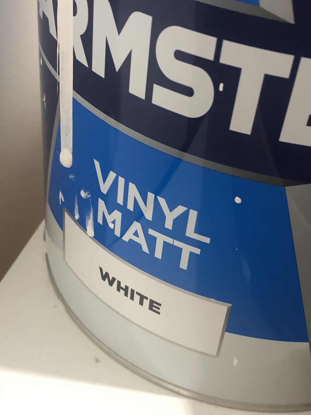

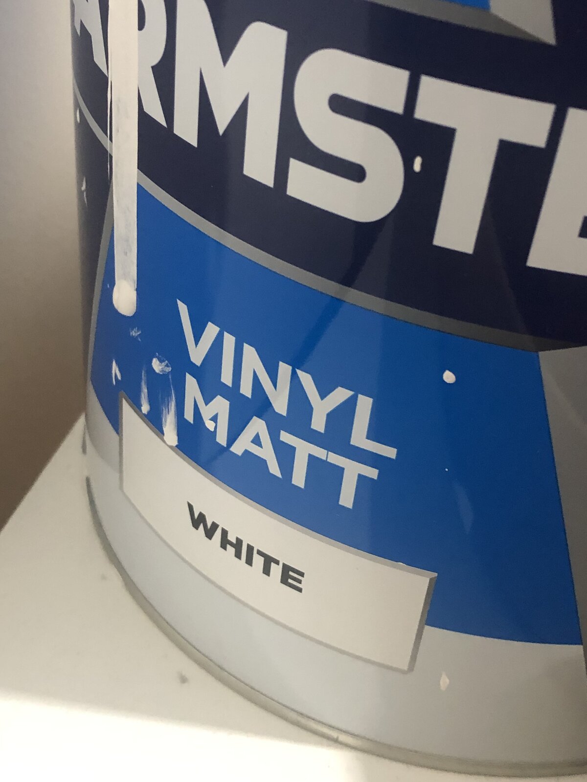

Looking for new paint, I was thinking of buying this dulux paint as we need something more tough and washable.
The only issue is, would we be able to use that paint over this vinyl Matt that we already have? All of our walls are currently painted with vinyl matt

Yes , two coats would be needed but yes
