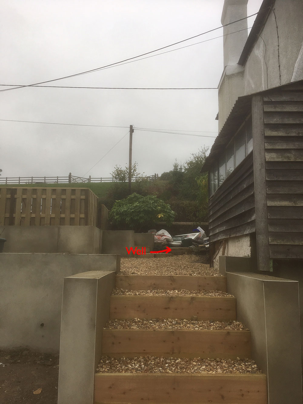

We've bought a house and all the walls are damp. We've discovered a well in the garden which is very close to the house. Its a very deep well and when it rains it fills up to about where the house foundations are.
Here is where its located next to the house:
Would the be water under the house or would the water just be contained within the well? If the water is contained within the well then thats ok. But if theres a chance the water table is coming up underneath the house then thats a big concern!

Is there any way I can gauge whats going on with all that water? As you can see from the photos, its not on flat land.

We are on a valley floor - about 10 feet higher than the river. You can see a steep hill in the photos. I thin the water must be coming off that hill and filling the well up quickly. But theres no other sign of where the water is going to other than the well! The water level is probably about the level of where the bottom step is in the photos.

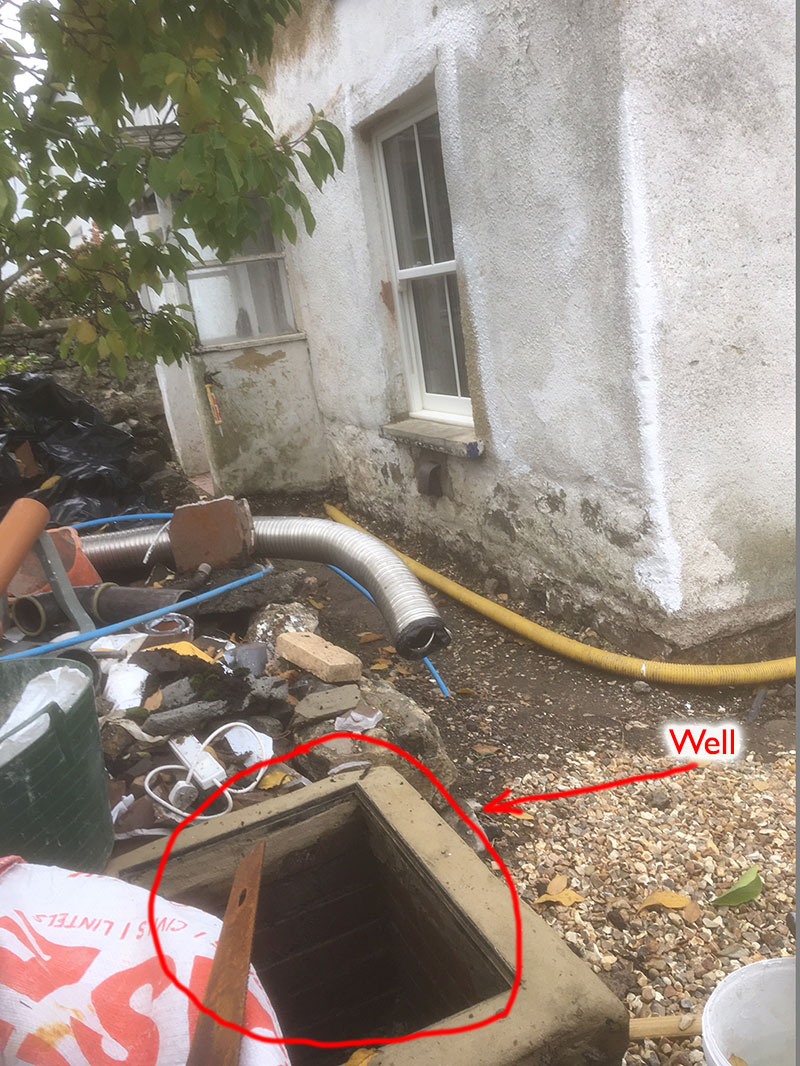

In the second photo of my first post you can see Ive dug the ground away to reveal the french drain. The ground level was certainly higher than the floor level inside, so I knew that wasnt good.
Now Ive dug away that ground maybe the french drain pipe can be disgarded? Ive been told the house doesnt have foundations (or perhaps very shallow foundations), so I dont want to dig down much further!

In the first photo, it looks like there's 2 pipes running in to the well?
Yes - an old copper pipe and a newer plastic pipe - both now defunct. They were probably used to pump water from the well.
