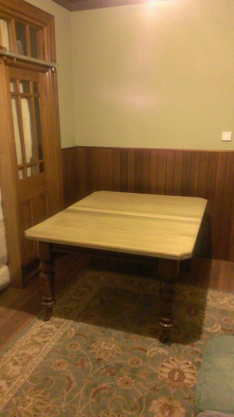

Could this table top be Maple?
5 Jul 2011
223

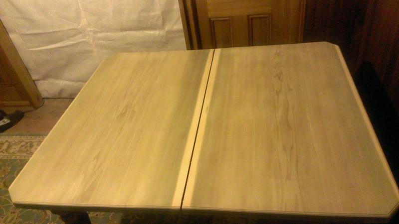

We got given this Victorian wind out table from older friends of ours that were downsizing. By design it must be around 120-150 years old. I am bringing an old house out of the 1970's and putting it back into the Victorian era and have worked with a lot of timber species along the way so I know my oaks, mahoganys (Merranti etc) Pitch Pine, Douglas Fir etc.
The table frame and legs are clearly oak but the top clearly isnt.
Ive no experience of it but for some reason I think its Maple. You can see the heart wood, sap wood, each leaf is made of a full slice of tree. The sapwood is very creamy, the heartwood has a very subtle green tinge to it, sort of a greeny gray. Ive sanded it back to bare timber in order to danish oil it. It had been badly stained by someone along the years. The dust from sanding is a light brown like the top of a capucino coffee.
Do you think it is Maple? Any other thoughts?
Cheers
If it's British-made it's highly unlikely to be maple. Maple isn't a native species, originating in North America, and isn't grown here in any commercial quantity. It is far more likely to be the introduced species, sycamore (sometimes called field maple) - which came with the Romans and is a very common hedge row and coppice tree. It was frequently used for kitchen draining boards, shop counter tops, chopping boards, utensils and all sorts of treen in the Victorian period - as a kid our draining board at home was maple and was scrubbed almost white. Because it is a close relation to the North American maple the timber grain looks very similar
I'd agree. It look like sycamore to me. That slightly more swirly figure in the middle is typical of what I've seen. Nice table too, looks as if it's been made out of two consecutive boards to make a sort of "book match" The boards will most likely have been cut up and rejoined in order to take out the stresses that build up in the drying process. As said it looks as if they have.

Field Maple, so it is a sort of Maple you think then. Ive just looked up pics and grain, workability etc and end grain and it all ties in.
Thanks for that. The oak frame then? Probably English oak?

ps table top is definitly not a jointed board.

It's difficult for even experts to tell exactly what species timber is without microscopic examination, but it's more likely to be sycamore given it's probable age, and the fact that it's been cut from full width boards. It's in no way inferior IMHO.
Imported timber is usually sawn up to make "packs" of square edges timber for shipping.
Most likely that the legs and frame are English oak.
