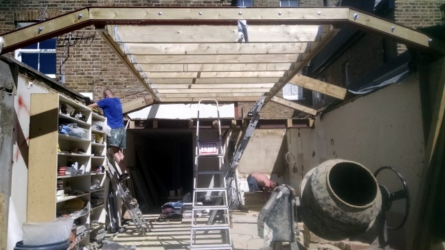

Pic as promised attached...flat warm deck with pitched sides.

You'll be counter battening that roof because you will need to extend the flat roof deck and cover down that shallow pitch.
Ok, counterbatten and batten it is then. 25mm x 50mm ok? It costs me same as the smaller stuff unless you tell me I specifically need the smaller stuff. Aiming to use natural slate, 8mm or so thick.

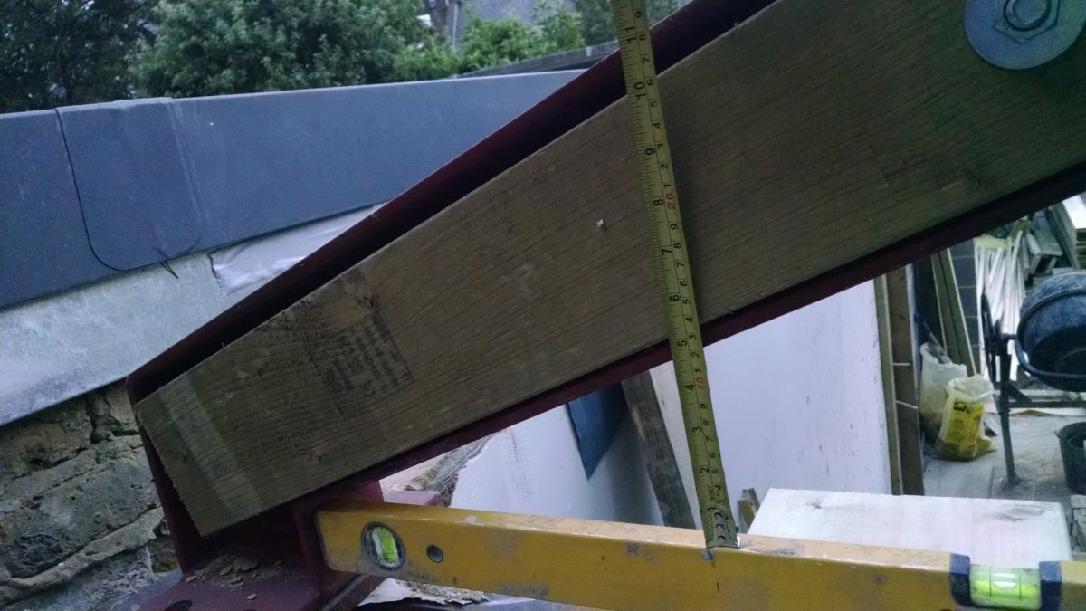

Woody, further to your post, I panicked and went to measure up. :D
To be double sure, I also installed an angle app on my mobile, put it on a spirit level to ensure it was calibrated and got 18 degrees on one beam and then 20 on the other, which I think makes sense as I measured about 4.5" inches rising (after marking 12" across the level, holding it plumb).
I'm being a bit thick, but do you mean I should cover my side pitches with a sarking board (I have plenty of OSB3 T&G board 18mm on site), leaving a gap of about 5mm between each board and then counterbatten + batten on top of that? Or do you mean something else? Pitch is about 18 to 20, as per my post above.
get it right 20 degrees is really the limit for natural slate
Would you advise I use something other than slate? What if I was to lap the slate more than necessary would that be ok?
