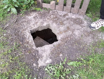

HI there, in the local park we have a hole over an old unused land drain)
It's been there for several years, every now and then the parks dept do something totally inappropriate like throw a cheap paving slab over it or a pallet.
This then gets broken by the yobberrati.
The park friends group would like to do something more permanent, can you suggest a better thing to cover it.
There must be a manhole cover type lid we can get that's going to be vandal proof and more permanent?
(Council approval is not an issue).
surely there must be water running underneath?
otherwise you could shovel rubble or earth into it and it would stay full.
how do you know it is a land drain?
Get a proper Grade A (Heavy duty) cover and frame, they wont lift it without the proper keys, and it'll be in no more danger of being lifted/stolen/lobbed in the brook than any other cover round and about.

It's an unused drain, the rest of it caved in years ago.
I know because we have several of these land drains in this area, very common in them thar hillls.
Oh, and the council parks guy told me so :)
If someone fell in there and claimed from the council, that hole would disappear immediately.
