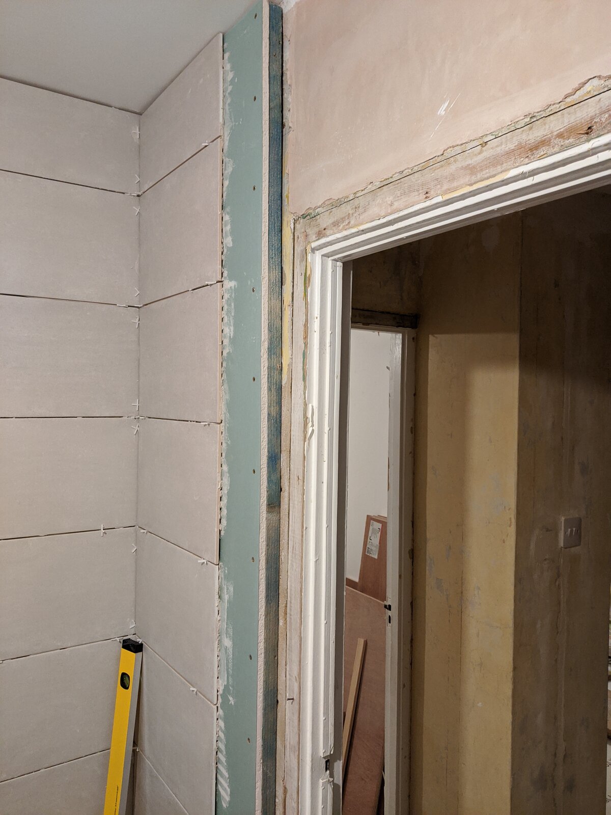

Hi all,
I'm continuing my quest to tile the bathroom and will be coming to a point where i will be laying the last column of tiles soon. It's on a stud wall and that edge will be sitting against the architrave. What's the best way cover the tile edge and the studwork? I could potentially use thick enough architrave although I don't think that will look great and it will still leave the bit above the door exposed.
Something like a T shaped edge with one side to cover the tile edge and the other longer side foe the PB and a stud. Does anything like this exist? Stud + PB is 35mm thick.
Thank you!

given what youve got in front of you , i’d board the narrow edge of the batten then use a tiletrim down the whole length .
allow it to overhang the edge by 3-4mm and skim or fill the short side at the end.
