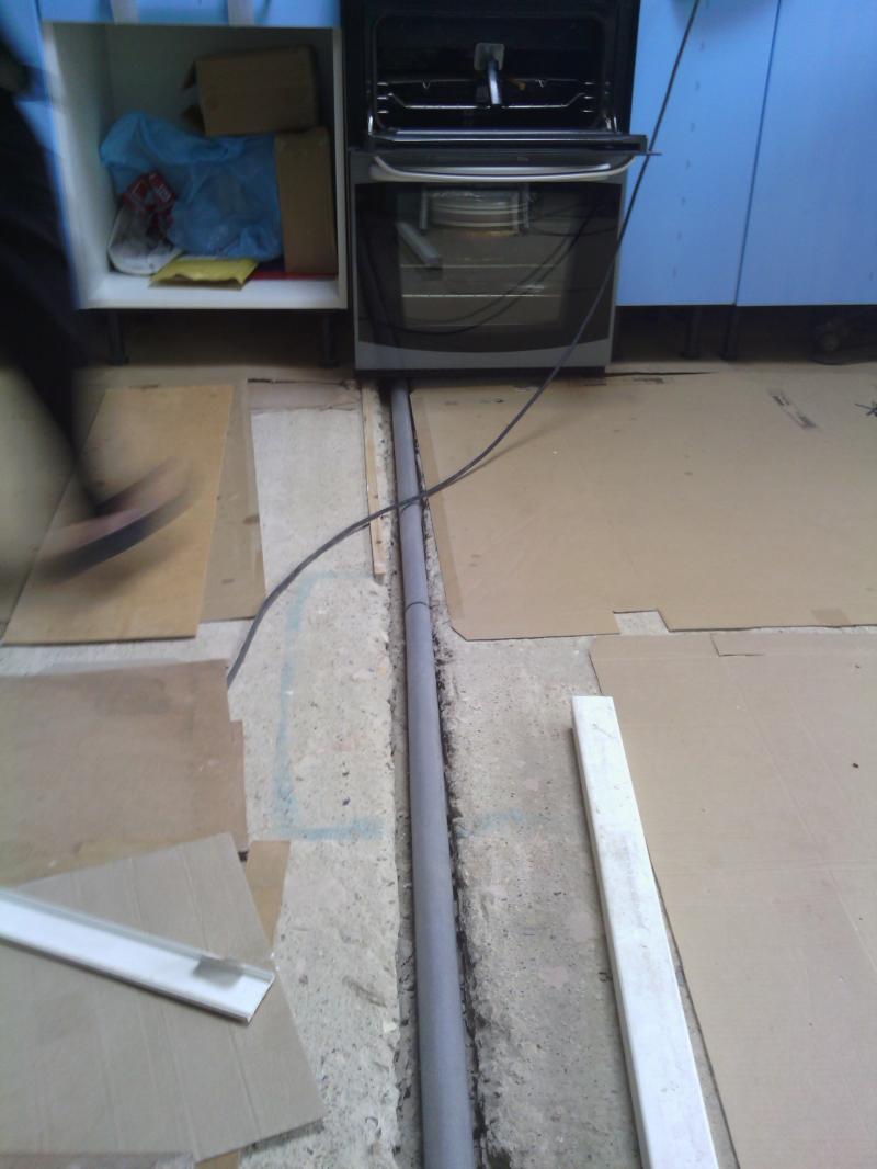

Hi, Think i posted in the wrong section before..
my gas cooker line has been moved. The pipe is laid into a concrete channel 8-10cm in width and will have more than 25mm in depth from the finishing level. It has a 10mm thick round foam covering on it. My plan is to fit under floor heating and then a self level compound, then tile using ceramic or porcelain.
1. I presume the channel should be covered/bridged to support the tile/protect the pipe from impact and adhesive ? is stainless steel sheeting ok? 1.5mm thick/ 16 guage.
Many thanks.
Well, that bit sounds like it could be ok but it's hard to give advice because there are several other things you'd have to be getting right with a gas pipe.

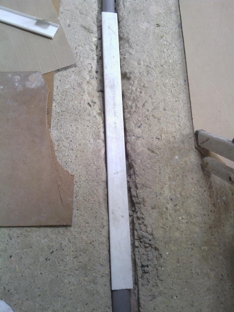

Hi Chris thanks. I've got some pics. Hopefully more info would help.. I could use the plastic square trunking over the pipe(22mm x 3.6m length) and leave one end under the cooker open - 6 inch square area or more if needed - so its just foam. No tiles or metal either. So it would be ventilated.
The pipe originates from underneath a wood floor which is also ventilated - normal house vents. Then i would use the 16 gauge metal sheet and tape this down before Self levelling, making sure nothing seeps into the channel. sound ok ?
The slight problem that I see is that metal is not supported on anything apart from the foam.
Not that that is likely to give any problem but not ideal.
I would wonder if covering it with lean mix concrete might not be better?
Tony
Hi Tony, I guess you mean putting it in trunking then filling the channel with the lean mix. I understand that cement can be corrosive to copper. The concrete surface is higher than the trunking. How lean do you think ? a wet sand cement mix.. so it gets underneath the trunking.
As long as the tile is supported and i can use electric underfloor heating then its the solution i've been looking for. Obviously i don't want to fall foul of the regulations. I could also cut the mat so it sits around the channel. Thank you.
