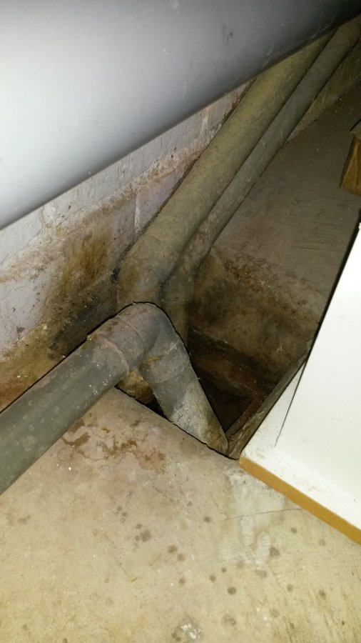

Good Afternoon All,
I hope this is in the most appropriate section, but apologies if not.
Long before we bought our house the property was extended to the side, over the previously external manhole covers and an open exposed drain. The kitchen sink waste comes through the old external wall and drains into the open drain, as does the washing machine and dishwasher. The open drain feeds into the main drainage for the house, accessed via the manhole covers.
However, this drain is no longer external and therefore would like to tidy it up.
What are the options for covering this open drain? I assume access will still need to be maintained in case of blockages in the future (but maybe not) but I am unable to find anything suitable on the web to do so. Ideally some kind of surface manifold that I can connect the sink /dishwasher/washing machine waste into would be a neat solution. Something that sits flush with ground level would be ideal to, but only from a visual point of view.
The open access drain is ~4" square (~5" below ground level), before widening ~0.75" all around at a small step then tapering up to ~8" at ground level.
Any help or advice would be greatly appreciated. Thank you in advance!

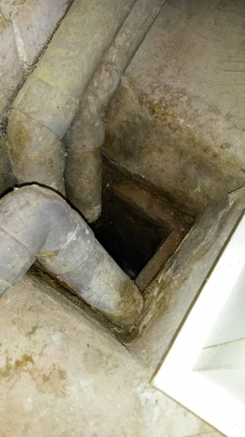

Hi Ian,
Thanks for the help and the link. Sorry but I don't understand what you mean? I cannot see how what you have described would help, but maybe it was my poor explanation!
I have (hopefully) attached a couple of pics with this reply to show the drain, which should help any further advice.
I should also add that I don't really want to get involved in any digging/re-arranging of the drain itself, more a simple cover to close it off and tidy it up.

OP,
You have to seal the gulley or risk vermin possibly entering your property.
Why not measure the gulley opening dimension or make a cardboard template, & take it & a pic to your local plumbing or builder's supplies.
They will fix you up with a gulley grid.
Cut the pipe stubs that point down to just above the gulley opening, and then slip in the grid so that it rests just below the cut stubs.

The gulley is not a vent and doesn't vent anything.
If it originally was a yard gulley then its almost sure to have been trapped - is there permanent water in the gulley?
Cleaning out any trap sludge often helps with removing smells.
Its unlikely but if there is a sewage problem in the gulley drain line then the place to start investigating would be from the manhole.
After trap cleaning you could run a hose down the gulley past the trap to "jet" the drain line.
Its not OK to completely seal the gulley off - you are obviously still using it.

The manhole, and the soil & "vent" stack provide any necessary venting.
You could make a template from a ply offcut and silicone seal it to the gulley rim.
The pipes would have to be cut, rearranged, and let into the ply cover.
The pipes would then have to be re-connected.
All pipe stubs should be let down into the gulley and stop above the trap water - you dont want waste water swirling around the gulley recess as is happening now.
