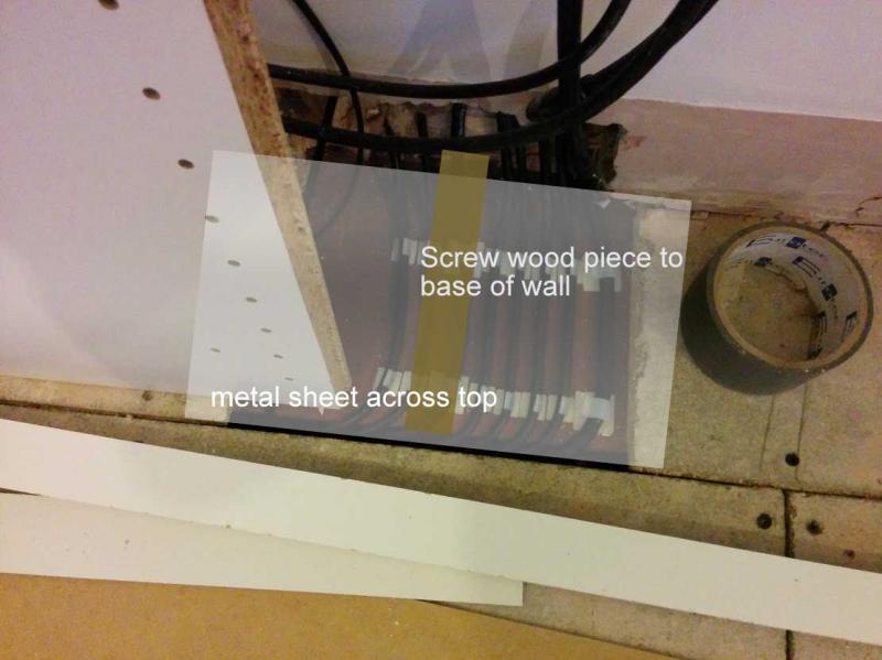

Any suggestions on how best to cover this area [see picture below]

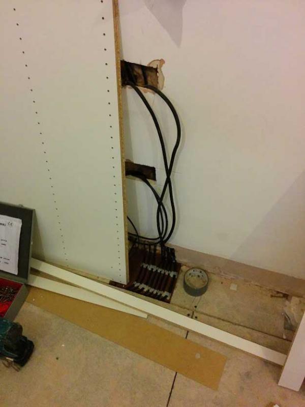

The cables are lying on the girder. This was to allow the cables to go up the wall. I have a few ideas, one includes adding a small wood piece to the base of the wall (studs/plasterboard) perpendicular and right in the middle and add a thin metal/steel sheet across it.
For example.
The cables are video/audio/data and will be one electric cable also.
Any ideas appreciated. Thanks :D

Also the that sections was cut out by the carpenter to make room for the cables. As for the rest of the flooring, its fine, it almost new.

Cant add the same board as it wouldnt fit as the cables take up the space. So the board even if cut properly cant go in that space. Thats why i was thinking a thin metal sheet supported by a small wood piece.

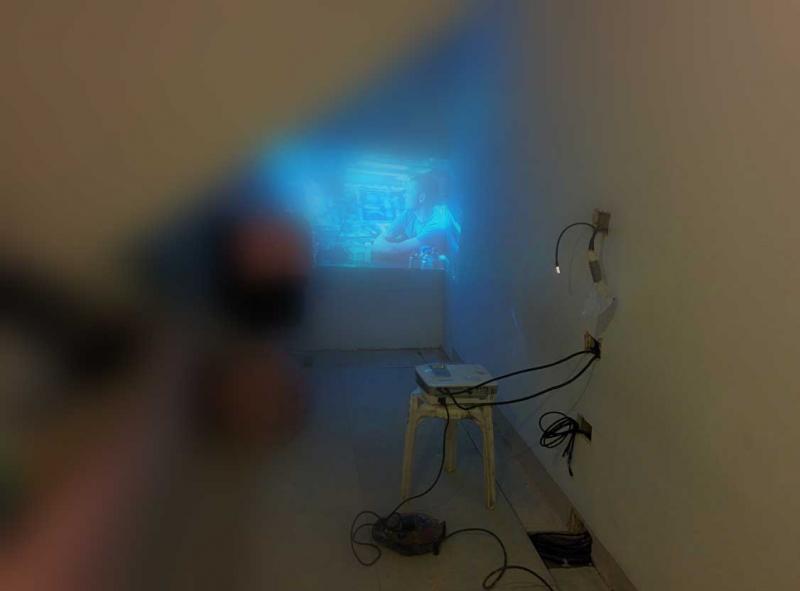

Cant take any other pics right now but heres some other I already have.
not been though out then unfortunatelty

Must remember we're not holding up a roof here. Its just an 8 or so inch span which is ontop of a beam.
Not sure what needs to be spec'd or thought through.
Having said that, yes its not ideal. But was the only option to pass cables up the wall from under the floor.
I think i'll just add 3 wooden batten between the cables (either edge and middle) and screw in a thin sheet of steel.

work out what thickness off steel you can use without touching the the cables
if you feel it will be strong enough then rebate the timbers all round to let it sit flush and secure
i know its not a roof but underspecked flooring will creak and groan and possibly fail if overloaded
its up to you really iff its under spec it will be fine if not overloaded with furniture or footfall
i try and go for up to standard and take it from there rather than aim for the minimum and hope
Agreed will do as much as possible to make it solid, will add wood between the cables and have a 2-3mm (maybe) steel sheet to cover it. Thats really all that can be done, it would have been perfect if the area had more depth but its only about 18 or 22mm (based on the chipboard size)
Anyhow, will get the measurements and clearance of the top of the cables to floor level and buy steel piece accordingly.
