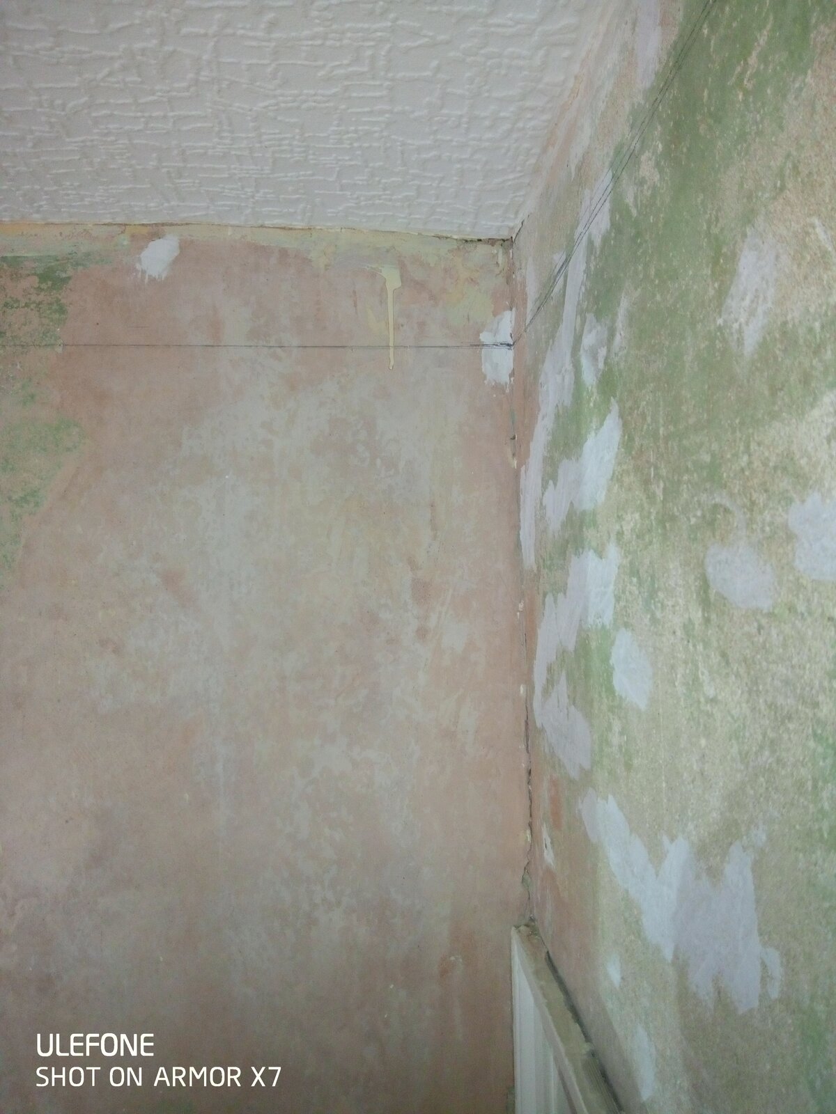

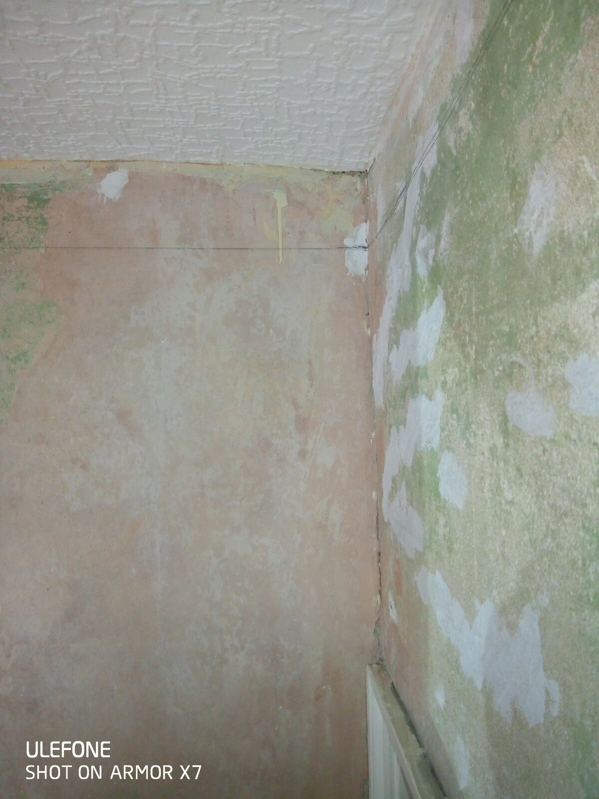

Hi. I thought I would like to cove this old house. I bought some polystyrene coving from B&Q and a tube of coving adhesive.
I watched a few videos on YouTube. I made myself an 82mm square block and proceeded to mark the corners in view of pinging a chalk line on the wall and ceiling. However, I then discovered the corners were not square.
Some dip down and some rise up with dips somewhere near the middle of all four walls.. So, I started to measure the dips which are somewhere between 15mm deep all round. With such a variation, I realised that if I put panel pins all round the wall to shelve/support the coving, the gap at the top being sometimes the whole way across or just small spot to attach the top to, I am kind of stumped at present.
I also realised I need to remove the ceilings wallpaper border to expose a firm surface to eventually attach to top/ceiling part of the coving to.
Any ideas would be much appreciated!

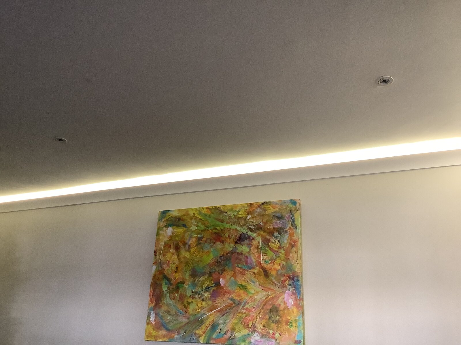

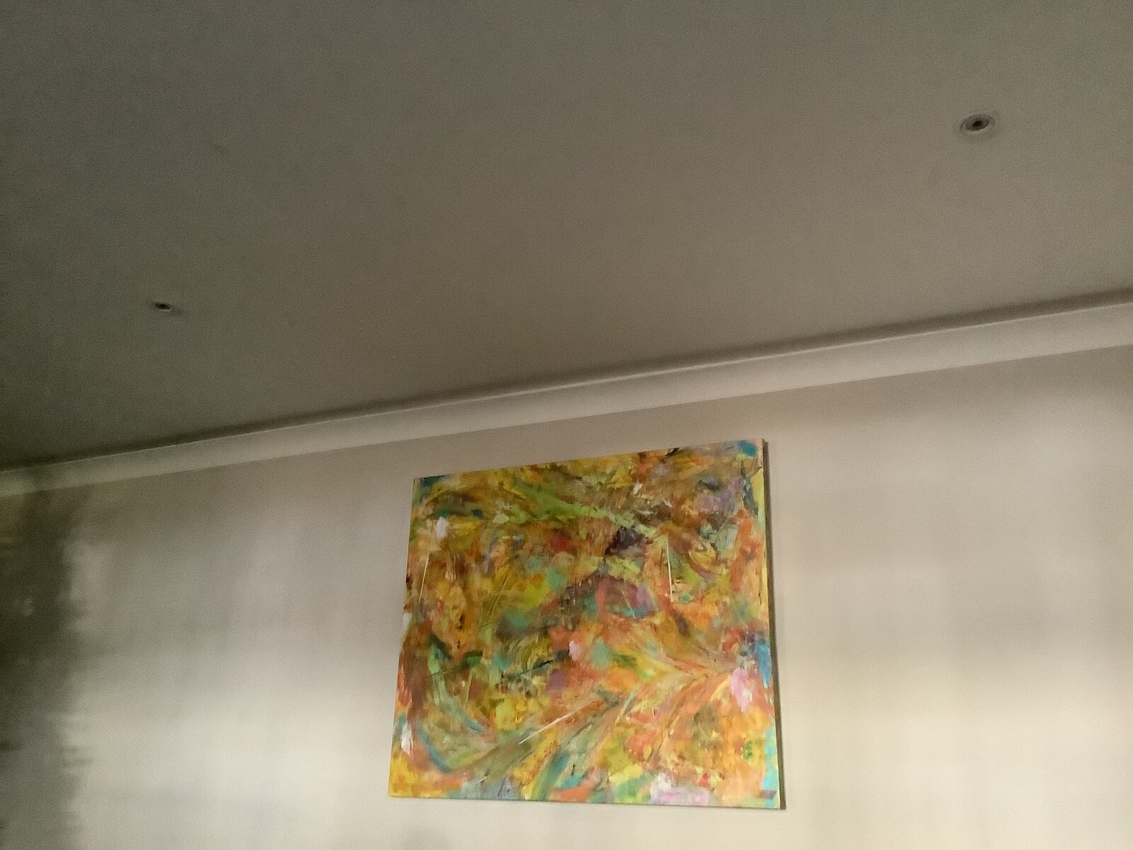

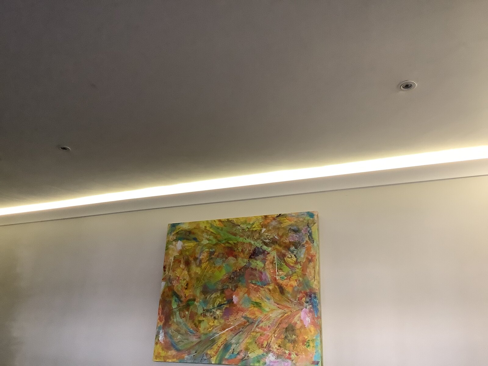

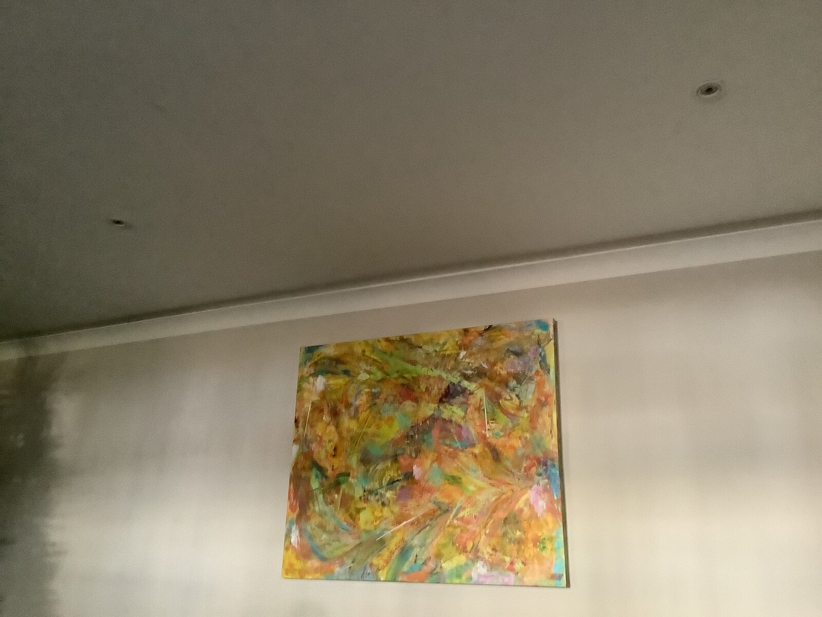

You could drop the coving 30mm or so below ceiling and a have shadow effect, I put led’s in mine.The lightweight cardboard covered coving is better than the polystyrene, looks like plaster coving.

trouble is itll be 30mm in parts and only 15mm in other parts.
15mm is nothing really, have you actually offered a length up to see if it will somewhat follow the contours.
Still, it needs to be firmly attached the ceiling edge due to the flimsy nature of the polystyrene. I am thinking maybe dot and dab, line it up nicely, let it harden, then fill it in nicely. Can't think of any other way.

To level the ceiling up and take the dips out you could get a straight edge and some bonding and screed the edges ive done it to a few ceilings you will then have to skim the ceiling , also if you have the opposite to dips where the ceiling bows down you can scribe the top of the coving to fit

which room is in the pic? Is it GF or FirstFloor? investigte to find out why its dropping more than 15mm. thats more than a 15mm droop.
do you intend to live with that ceiling paper becasue nows the time to remove it if you want a fresh ceiling finish.
That's exactly what I would do as well Steve, a far better looking job.
