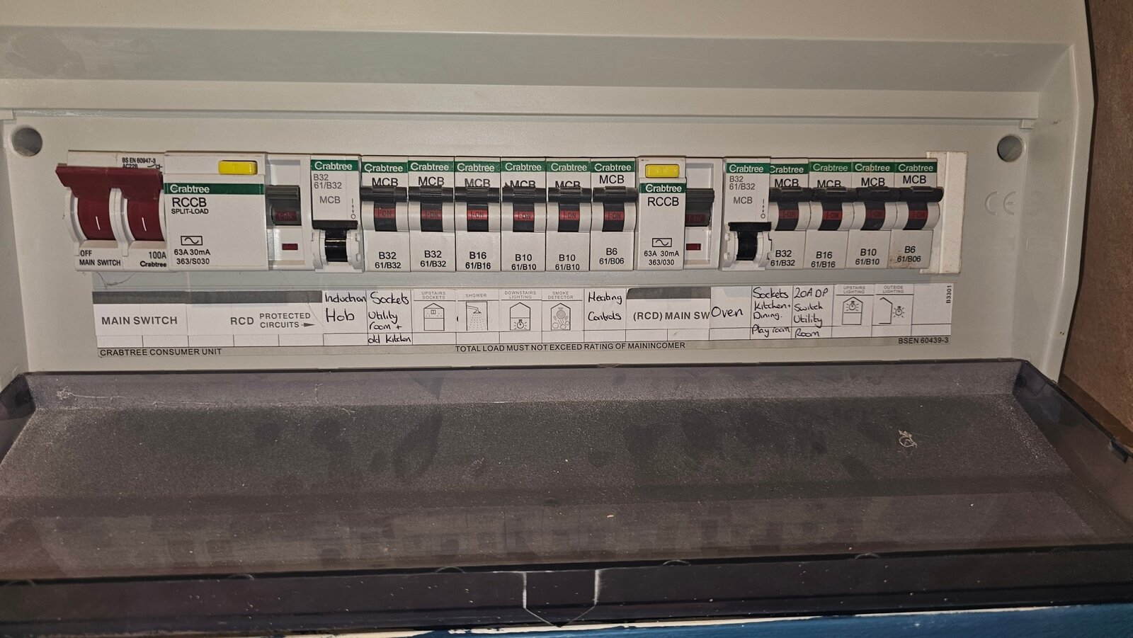

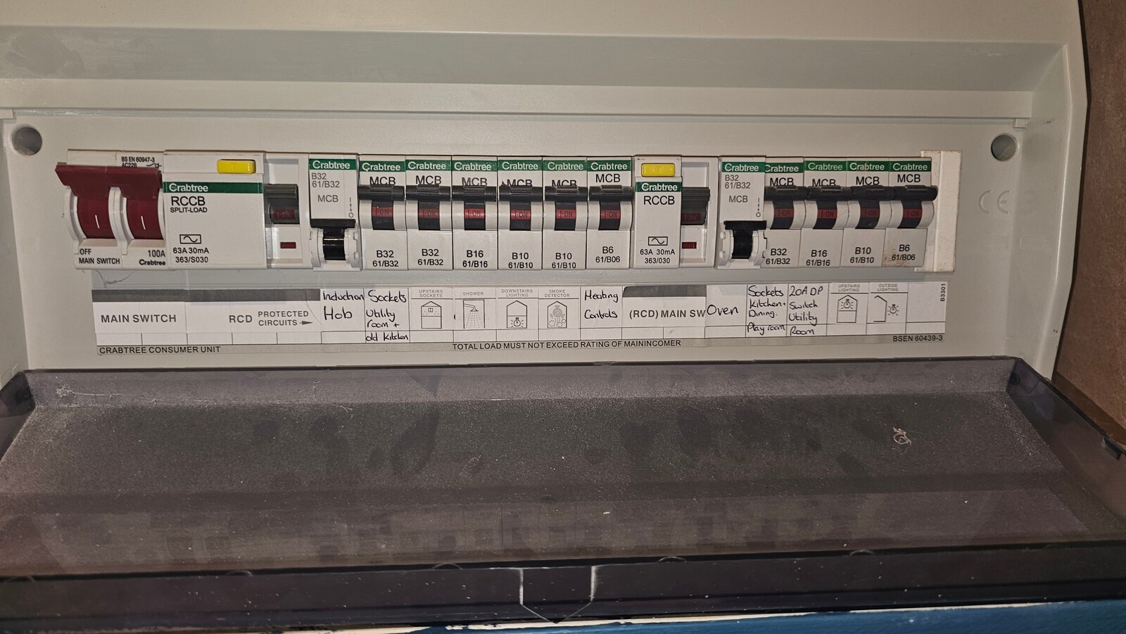

Having done some reading it appears my consumer unit contains 2x bus bars, the circuits on the first bar are protected by the S030 and the circuits on the second bar are protected by the 030. What makes the 2x RCCBs different? What is different between "main incoming applications" and "split load applications" in the paragraph above?
Note: here's a photo of my consumer unit:
Thanks in advance :)

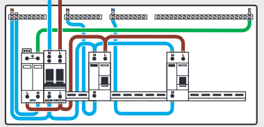

It sounds to me like the "split load applications" version is designed to pick up the incoming live from a busbar at the bottom, while the "main incoming applications" version is designed to have the incoming live fed by a wire entering from the top. In the context of a "16th edition" split load layout this would save the need for a live link wire from the main switch to the RCD.
When the 17th edition of BS7671 came along, requirements for RCD protection were expanded significantly meaning most domestic circuits would need RCD protection. However, putting a full install on the same RCD was frowned upon and RCBOs were expensive. So we saw the introduction of the dual RCD split.
Since the first RCD is next to the main incomer it can be supplied by a section of busbar from the main incomer and a "split load" style RCD can be used. On the other hand feeding the second RCD from the first RCD would defeat the object of having two RCDs, so it's incoming live has to be fed by a wire and a "main incomer" style RCD used (even though it isn't actually the main incomer.

What I wanted to know was if there is a possibility to add a non RCD protected MCB to the unit (i.e. between the Main Switch and the 3-module RCCB in my CU), for a circuit to provide some power to an outbuilding with it's own small CU.... Maybe my only option (unless upgrading the CU) is to have a sparky add henley blocks to the meter tails with a switched fuse supplying the SWA.

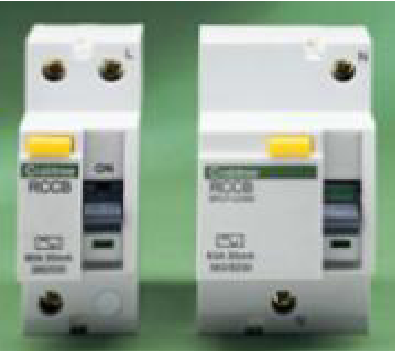

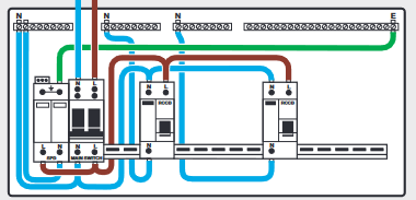

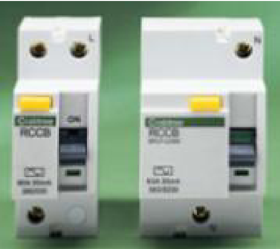

The picture on the data sheet 1723818315036.pngshows the split load RCCB in the centre and the RCCB picture1723819244628.png shows the split load has neutral only connections, where the non split load has a line input. But the text tells us the non split load has one pin and the slip two pins, so in total same number of connections, so I am as intrigued as you are as to what the difference is? I know the first RCD's I worked with were 4 module width, it always seemed odd to me to have DIN rail which is a German standard, then move away from the standard by using clip in buzz bars or half DIN rails.

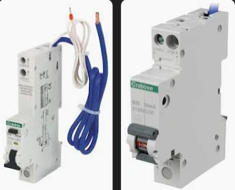

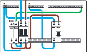

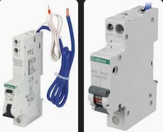

But it depends on the consumer unit this 1723820106729.png shows two neutral bars, this 1723820153545.pngshows three neutral bars, and to have a non RCD protected section it needs to have three neutral bars. I note Starbreaker RCBO's are available 1723820641340.png but at £40 darn expensive, so my work out cheaper fitting something like FuseBox CU instead. I wonder myself what the answer is, clearly likely can do some botch, but for a CU to be a CU it needs to be to manufactures design, any change and it is no longer a consumer unit, it is only a DB.
Yes, you can do that by altering the busbar if they are still available, or by some other means.
I once used a Loadstar MCB which does not have the plug-in terminal and supplied it with a wire from the main switch but I suppose no one will do that.
That would be better.
